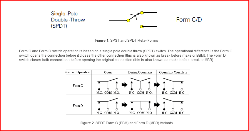

Original Question: Can I have a capacitor that is charged with the battery when you activate one switch and that releases the capacitor energy when you activate the other?
In other words, there are two circuits - one for the battery to charge the capacitor and one for the capacitor to release its energy to a coil of wire.
Are there capacitors that work like this or will I need to build my circuits some other way?
Sure. Switch 1 connects the capacitor to the battery. Switch 2 connects the capacitor to the coil. First close 1 and open 2, then open 1 and close 2. Can you draw the circuit diagram for that?

Better yet, use one SPDT Form-C (break before make) switch...
http://www.ni.com/product-documentation/4453/en/

You could also put a big enough resistor between the battery and the capacitor so that you don't have to disconnect the battery. Then you only need one switch, and you don't need to worry about the timing of opening and closing the switches. Of course this will slow down the charging, but maybe that's OK. This is basically how a camera flash works. On many of the flash units, you can hear the capacitor re-charging after you fire the flash.
