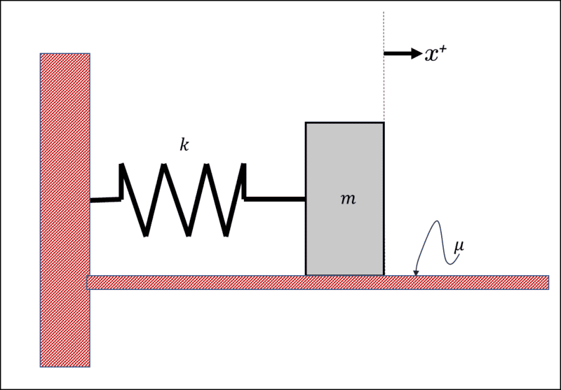

Diagram of a block of mass m on a horizontal surface with coefficient of friction μ, attached to a spring of constant k anchored to a wall on the left; the positive x-axis points right.
Suppose we have mass ##m## attached to spring with constant ##k##, and some coefficient of kinetic friction ##\mu## between the mass and the surface. Its displaced from equilibrium by some distance ##x## at ## t = 0 ##. I've come up with the following ODE to described ##x(t)## using the Heavyside Step Function to capture the changing in direction of the frictional force as a function of ##\dot x ##:
$$ m \ddot x = - kx + \mu m g \left( 1 - \frac{2}{1+ e^{- \beta \dot x}} \right) $$
where ##\beta## is some arbitrarily large positive constant.
I don't suspect that to have an analytical solution, but what are the alternatives for this type of problem?

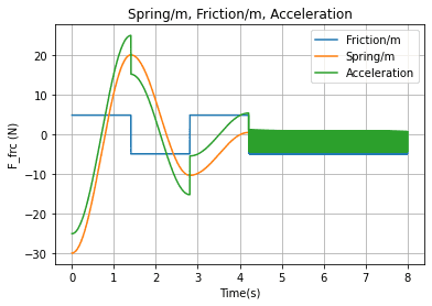

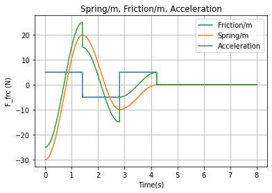

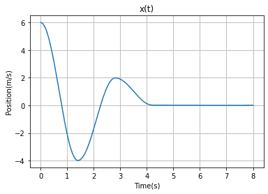

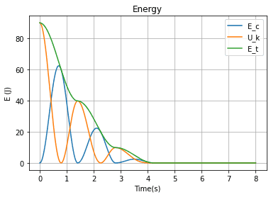

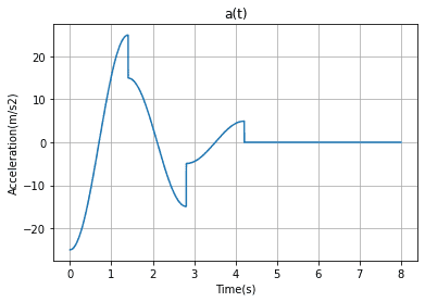

I did that not too long ago. However, I added one more condition to be able to consider the difference between dynamic friction and static friction. Setting both values to be the same so it's closer to OP causes this result for the following initial conditions.
##m=1##; ##\mu_{dyn}=\mu_{stat}=0.5##; ##g=10##; ##x_0=6##; ##v_0=0##; ##k=5##
(I know, ##g=10m/s^2## feels bad. But the computer goes crazy otherwise. I'll show you what happens later if I try that).
Line plot titled x(t) of position in m against time in s from 0 to 8 s: starts at 6 m, falls to a minimum near -4 m at about 1.4 s, rises to a peak near 2 m at about 2.8 s, then settles to 0 by about 4 s.

Line graph titled a(t) of acceleration in m/s2 against time in s from 0 to 8, showing a smooth curve with several sudden jumps and then settling at zero after about 4.2 s.

Line graph titled Energy plotting E in joules against time in seconds from 0 to 8: kinetic energy E_c, spring potential energy U_k, and total energy E_t, with total energy decreasing in steps from 90 J to 0 by about 4 s.
If I try to write ##g=9.8## (or many other inputs) it seems the computer doesn't have enough precision when the mass is almost stopped because the friction force pushes it too far from equilibrium and it starts bouncing like crazy around that point. I could totally code that behavior out of the equations but I didn't do it. All plots are the same except those showing acceleration.
Line graph of Friction/m, Spring/m and Acceleration versus Time(s) from 0 to 8 s; friction steps between about +5 and -5 N, spring force and acceleration oscillate, then rapid chattering appears after about 4.2 s.

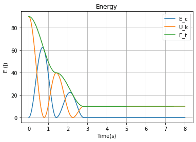

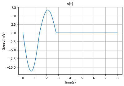

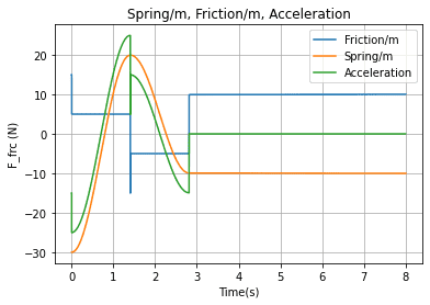

Lastly, as I said I added a condition to be able to catch the difference in static and dynamic friction. As a result, for some initial conditions, the mass can come to a stop at a point different than ##x=0##.
##m=1##; ##\mu_{dyn}=0.5##; ##\mu_{stat}=1.5##; ##g=10##; ##x_0=6##; ##v_0=0##; ##k=5##
Line plot titled x(t) of position in m against time in s: starts at 6, falls to about -4 near t=1.3, rises back to 2 near t=2.8, then stays flat at 2 through t=8.
Line graph titled v(t) of speed in m/s against time in s from 0 to 8: speed dips to about -11 near t=0.8, rises to about 6.7 near t=2.1, then drops to 0 at about t=2.8 and stays at zero.
Line graph of Friction/m, Spring/m and Acceleration in N against Time(s) from 0 to 8 s, showing sudden jumps and smooth oscillating curves that settle after about 3 s.
Line graph titled Energy plotting E in joules against Time in seconds from 0 to 8: kinetic energy E_c and spring potential energy U_k oscillate and decay while total energy E_t falls from 90 J to about 10 J, then stays constant.
By the way, I'm not sure about the results I got. I suspect there might be some minor bugs about the point where the mass changes direction but the results feel right on a first look. Feedback is welcome.
