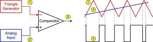

So what Synch is doing with the voltage from pin 5 is only taking a frequency, then using that frequency to create a pulse train to send into the flip flop and Nand gate? So it wants to use that frequency because any lower won't work and any higher will be inefficient?
The only basic experience I've had in this area is that I remember seeing a diagram years ago of a triangular wave and a reference voltage, and everytime the reference level the MOSFET (or whatever) turns off (or on?) creating a pulse train, I assume this is something like that?
Thanks heaps for your help Dave!
Yes, basic PWM modulator
http://www.planetanalog.com/author.asp?section_id=483&doc_id=559556
http://www.ti.com/lit/ug/slau508/slau508.pdf
