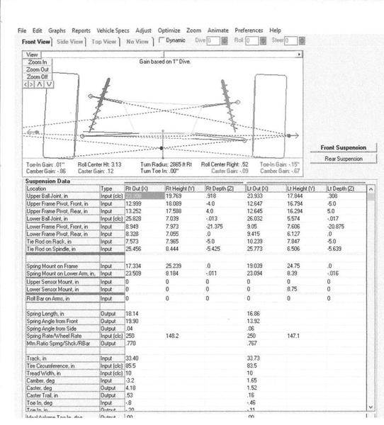

RM - Whew…measuring, changing and re-measuring RC - what a process! But we have been able to get the RC to start out at 3.4" above ground, 2.8" Right. But, I have measured my CL based upon the frame center, and not tire patch. Since I'm running offsets and spacers the tires would cause the CL to shift 1.5" right. Thoughts?
What I have also noticed, by driving change with the software, is that there is a certain rate of change caused by two variables - dive and roll. By "Analyze Suspension" the software is telling me that I should expect 2.3" dive and 1.6* roll. Is there a particular equation I should be looking at?
Also, the software discusses 2 CPS for RF (LF = 0.85RF) and 1.6 CPS for the rear. Steve Smith's Advanced Race Car Dynamics suggests 2 CPS and 1.4 CPS. If I go 'by the book' my RF spring rate will increase to 1163#! This seems way above anything that I've talked to others about.
Right now, based upon my current set up my RF CPS = 1.8, all others = 1.6
If I follow the logic of 1* roll / 1" travel, the RC:
@ 1 = 2.5"H, 5.3"R
@ 2 = 1.7"H, 10.7"R
@ 3 = 0.7"H, 23.0"R
But, if I plug in the MAX dive/roll that the software suggests (2.3" / 1.60*):
RC = 1.5"H, 10.4"R
Finally, my anti dive is: RF = 8%, LF = 5%. This is very close to 'textbook' - 10%, 5%.
It may not look like it (by looking at the car) but we have made several changes. Interestingly enough, we are running the same BJs for the lowers and the same for the uppers. (I would have expected to stagger these.)
I really like the software.
  • #636
Wow- good job racer! Gives the public an idea just what we do in the winter in a cold garage!
There is a lot to digest. When you use wheel spacers to move the vehicle center line to the right we are adding left side weight. I assume your roll center calculations are based on the final adjusted center line. We try to run as much left side weight as we can get away with. Even used to crank in the ARB (sway bar ) adjuster before rolling across the weight scales.
I am very impressed that you have taken the time to read up on your ideal setup from various source..Excellent.
To all racers a word of caution- I swear by using software programs like this one to measure out where the car is and base line it. BUT,,do not get over zealous and start gaming the race car set up. Two huge factors will ruin your ideal set up you have gamed out.
Reality and Aero. All the software in the world can not predict real world things like damper dynamics ( shock action), true spring action, ARB action, and the 32 some moments on a typical stock car. Shocks will heat up and permit more dive/roll during the race. You are burning off weight every lap ( as you eat gasoline). Tires go away from lap 1 on..just the reality of it.
Aero dynamic drag is a lot more problematic and can not be accounted for with this software.
I rely on the software as much as my pyrometer. It is a tool only and should be thought of that way.
On dive and roll, i think you have done a lot of work and should stop.
You have the RC exactly where it should be at static. All the software has indicated it will migrate to the right. I don't really care after 2 inch travel where it ends up as the the max weight transfer has already happened.
Until you can read the shock stops after a hot lap and know actual shock compression, everything else is a guess.
no way will a 1100# spring work.
Good job on anti dive. I think you have taken it as far as you can in the virtual world. Now back to checking rear steer and making sure we don't have suspension bind anywhere. Make sure you do thorough bolt check and get rid of any farm bolts and bolts under grade 8.
you got a real good jump on the competition this year.

  • #637
"I assume your roll center calculations are based on the final adjusted center line."
No. If I need to take this into consideration then my RC is 4.3" to the right. If I make any efforts to shift it further left, the RC really starts taking off to the left which will only make the car 'feel like' it has a very soft RF spring. (Which was the case last year.)
  • #638
Also, to get the RF CPS to 1.8 I ended up with a 950# spring.
LF 850, RR 150, LR 200, all equal 1.6
When we tore the front suspension apart we immediately noticed issues with the lower control arm mounts - they weren't lined up. This took a bit of 'fabricating'. Afterwhich, we used 9/16" drill rod to make sure the pivot point was in line. We then used a digital angle finder to make sure that both sides were as close as possible - 0.5*. We also used a tape measure to make sure the heights were the same.
With all this, and since we are allowed to run tubular uppers, we contacted a respectable company to have uppers made with the specific caster offsets as well as the correct lengths to get the RC where it needs to be.
Like I said, what a process! Hopefully we'll have a play-day this weekend.
Now all I have to figure out are my shocks. (Right after I check the rear end.)
