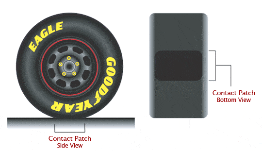

welcome Al..in my opinion it is all about the tire contact patch and camber build is the enemy..looking at it from a designers point of view if you have unlimited funds and can do it go with the longest control arms and make them parallel

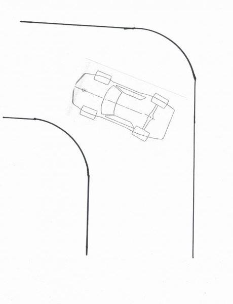

There recently was a request to assist a poster on Physics Forum on calculating the path of a car in a turn. I pointed out the fact that it isn't that simple and you can not fit a static model into a kinematic environment. Even if you can get to thinking in 3-D you have to add in many variables and no amount of math is going to tell you where the car will be in a turn. For one thing you have a human driving and we all know how flakey those carbon units are!
Lets look at a right hand turn ( I know.. it’s a British thing, Billy Bob) oval track. The racing line is THE fastest path you are able to go thru a particular corner. In fact if you had an overhead view of an oval race track and mapped the cars location you would see a diamond pattern and not an oval pattern. The driver follows this racing line to take corners in the fastest possible manner. The idea is to find the best line with minimum turning effort and use the track banking to your advantage to shoot down through the corner for max speed. This line WILL Change, daily and most of the time hourly because of sunlight, temperatures, rubber build up on the track, diminishing tire grip and other factors.
How do you find the best line? You walk the track. You have to do the mental drill of looking for the Apex and figure out the best way to hit it. Once the Apex is found you find the braking point, turn in point and power on point of exit. You have to remember all these will change as the car and track conditions change.
Finding the Apex - The apex is the point at which you are closest to the inside of the corner, also referred to as the clipping point. Once you have hit the apex you should be able to reduce the steering lock and increase the throttle. There are two different types of apex, the geometrical apex and the racing apex. The geometric apex of a constant radius corner is the central point on the inside and this may also be the racing apex.
The traditional or geometric racing line
To carry maximum speed through a corner, you need to take the straightest line through the corner to minimize cornering force and keep up maximum speed. This route tends to use the geometric apex of the corner and is usually known as the classic racing line. Note the Apex location in the diagram . We have a constant radius 90 degree right hander and the geometric apex is exactly half way around the corner. This Apex will usually get you close to the fastest time but your car’s tire grip may dictate you needing to move the apex for max speed. More on this later.
The Braking Point – All drivers mentally mark the Bare Point, Turn In Point and Power on point when hot lapping. It is a constant process of finding the best line through that one turn and “hitting the marks” time after time. That is one reason the retaining walls are painted and marked before the apex. So you are bombing down the front chute to Turn One and hit the brakes...Wrong! You better have more finesse that that and you better have your Brake Bias cranked into where you don’t swap ends when you hit the Whoa pedal. Losing 50 MPH speed should be a controlled process. Threshold braking is the technique where you are on the brakes the most you can apply and still not locking up the wheels. You are on the binders doing maximum braking when you are in a straight line.
So how do you find the Braking Point for each corner? You shoot for the apex and begin braking early. As you learn each corner you begin braking later and later until you find the best braking point. IMPORTANT - You are on the binders doing maximum braking when you are in a straight line. You lighten up the pressure but still keep tension on the pedal when in the corner. This does two things. It assists turn in and sets the chassis. This is known as trail braking and is a proven technique to reduce under steer.
Turn In Point - Just like the Braking Point , you have to find the best Turn In point to get the line right. Hit it too late and you'll miss the apex, hit it too soon and you'll have to tighten your line mid corner. Get it right and you'll have a good racing line.
Power On Point – Once you have completed the turn and the car is close to being pointed straight you can get on t he GO pedal. No, we don’t nail the throttle and spin the tires! Finesse again. Learn to give it he gas without tire spin. This point will change as with the other points with tire grip and track conditions. You may have to shift the Apex to a later Apex to get the fastest time. What you want is to transition the turn and get the car hooked up with power on as quick as possible. See diagram. It is better to take a late apex, straighten the car out early and get the power on for a higher exit speed. One final note. If you hit the Apex too early you will cross up the car and miss your best Power On point and have a bad lap time.
Bottom line is the path around the race track is not a perfect oval..far from it and it is not consistent.

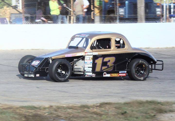

Ranger Mike,
We ran our first race of the year after setting up the RC. I have to say - I'm disappointed. I really expected the front tires to shred the track. The feedback from the steering wheel was smoother but the car did not feel like it would take too much 'wheel'. (I felt like the steering wheel was 'free', if that makes sense.) We re-measured the control arm angles and they are all different from our starting point but the RC is at 3.6H, 2.2R. (The lowers had 2* more and the uppers had 5* more meaning the front was lower overall.)
The car started off loose in/off so we put MANY rounds in the LR and took MANY rounds out of the RR. This in turn appears to have upset the front frame heights - the LR rose 1/4" while the RF fell 1/4" leaving the LF a tick higher than the RF. In the end the car ended up tight in (1of5), and loose off (3of5) and pushy at the apex (1of5). We also went with higher rebound shocks which seemed to help the weight transfer.
The tires themselves were older tires from last year.
Unfortunately we were fighting other issues and did not take tire temps.

It is better being loose going in and coming out then pushing going in, loose off.
Floaty feel of the wheel means rt front not getting enough weight to plant and turn the car. This means your set up is getting real close to a good set up.
Adding wedge at the track tightened up but not the answer. Basically makes the car a three legged stool. Can you lower the rear roll center?
Sounds like the front RC is performing as should be.
I assume you still have 3270 pound car.
what springs did you end up running? 750 LF 850 RF?
are the spring new or got a lot of racing on them? Old springs will mean your end of race setup will be sagging more than when you dialed it in on garage floor.
It does not appear to be rolling over as much as it did last year. So yes, that has improved.
3297# (full of 22 gallons of fuel.)
Left = 55.9 (versus MAX 56.0)
Rear = 46.1 (versus MAX 47.5)
Cross = 46.5 (after race. Most of the day it was in the 45s. We put many rounds in/out before the race.)
We did end up moving the motor back 3/4" and to the left 5/8" which allowed us to take off 25# of ballast. When we went across the scales with all ballast we had 56.1 LEFT so we had to remove 25# and ended up with 55.9. whew...I was given a nice little "I'm not going to make a big deal of that but you better fix that" speech from the official after the heat race.
RF = 950#
LF = 800#
We went with those as it placed us close to the ideal natural spring frequencies (which I appear to be caught up in.!)
I believe the RF is new while the LF is an older spring that was not used that much.

Here we have a real life teaching point. The problem is we have a “ new set up race car” that has ill handling. The question is ..why is it over steering on turn in, apex and exit?
The big gorilla in the room is “ sprung weight”. Everyone hates UNSPRUNG weight because it can not be controlled. That’s why racers mount shocks ( dampers) upside down to reduce the unspring weight by a miniscule amount. Sprung weight can be “ controlled” ( he said laughingly) with shocks and springs and ARB (sway bars). Step one in answering the above question is to find out how much sprung weight we have and determine where it is going.
If we look at Radracers car specs we have a 3300# car with 112 wheelbase. We assume a Center of Gravity height of where the camshaft is above ground and use 16 inch as CG height.
I assume a 66 inch rack width. I am using a figure of 1.15Gs as he has spec tires and a fairly flat track. (If you look up on this post on page 33 post 589 we can get details in depth on theses calculations.)
1. The total amount of weight that is being transferred during cornering
Tw= Gs' x car weight x CGh / track width
1.15Gs x 3300 x 16 / 66 = 920 total pounds transferred during cornering.
Weight Forward = Gs x car weight x CGh / Wheel base
WF = 1.15 x 3300 x 16 / 112 = or 542 pounds transfer to the front of the car.
Total weight transferred= 920# minus 542 # weight transferred forward= 378# weight going to the right side.
So we have about 1/3 of the car weight being slung around during cornering,
16% coming forward and 11% coming over to the right side of the car.

I think I'm getting too much front wheel travel. As I watch the videos I can see the RF tuck waaay up in the fender.
I'm not comfortable in the accuracy of these number but here it goes - the fronts don't have rubbers on them and I'm not sure if I 'reset' the rear rubbers.
RF = 1.6
LF = 1.3
RR = 2.3

RF = 1.6
LF = 1.3
RR = 2.3
LR = 2.8

I have pondered the obvious question - When I scale my race car, ( use electronic scales under each wheel) I get wheel loads on the rear scales of 975 # on the Left Rear wheel scale, and 485# on Right Rear wheel scale. But only have 200 # springs in the left and right rear of the car? This appears to be a disconnect.
What is going on?
The answer is actually in two parts and I now throw it open for discussion.:devil:
I'll be curious to hear this answer. First thought is compression of the springs but that would mean the LR would be in near coil bind.
Some old notes say:
Motion ratio: RF = .607; LF = .671
My upper and lower control arms from a 70-81 Camaro.
I think it's time to run some more computer numbers.
You've go me confused over the LF spring rate. Your last supposition has me running a stiffer RR and softer yet LF. But how will this allow the weight to transfer through the RC to the RF?
My rear springs are 17" to centerline. Tire to centerline RR = 34.1; LR = 32.1
Front ARB motion ratio = 1.007
radarcer – you have the most popular front end set up going. The GM Metric control arm is most used in hobby racing today. The ARB (sway bar) motion rate is almost 1:1 which means the 223# will subtract the load rate required by each front wheel spring. I came up with a motion rate of .54 for the lower control arm and if you did the math regarding instant centers etc.. the wheel load rate would be close to your .6 figure. That said it still looks to me like you have a soft RR spring and front end may be a little stiffer than ideal. All this math is of no consequence and I recommend you do the following.
3 inch wheel travel- so why get hung up on 3 inch wheel travel? For a typical door slammer class racing, on a fairly flat to medium bank oval paved track, this 3 inch travel on the right front wheel will yield the best handling possible. Excess travel means you have weak springs the camber build and bump steer go away and less than 3 inch travel means too stiff a spring and is less than the best you can get with this set up. If you have 2.5 inch travel that is great but still could be maximized as you are wasting 1/2 inch travel which could be used to give that much better grip than the other racer. Races are won by 1/10ths and some times by 1/100s of a second as we all know. You want your spring package to take the weight transferred and compress the 3 inch during corner entry. Then push the weight back just as you have completed mid corner transition and throw the weight to the rear tires for good traction at corner exit. The springs do this the shocks ( dampers) control the timing of this.
In an ideal world on a perfect track we want 3 inch droop on the left side front and rear and 3 inch compression on the right side front and rear. This is probably not going to happen. I would settle for 2 inch on the rear if you can not run a panhard bar due to the track rules.
The way we measure this is to find the shock travel length when the wheel is at the ideal 3 inch point. Unless you want to hang cameras near each wheel this is the cheapest best way of measuring things. Take the time to fabricate the droop indicators for the left side as the shock travel indicators are good for compression only. Cut rubber grommets and install them on the right side shocks if they are not there. This is the simplest and cheapest way to tell you why you are pushing or loose. Make sure your driver does not drive over sever drop off when exiting the track. Once you get the correct Roll Centers and they stay more or less constant thru 3 inch of wheel travel , and your camber build and bump steer are ok over the 3 inches, once you have proper ballast for the track rules % rear and % left side weight, once you dial in known good cross weight and have correct stagger get off the computer.
The computer is a good Tool but sometimes it will mess with your mind. Head for the track and start using the stop watch and pyrometer and look at the shock travel indicators. Happiness is a hot lap with 2 inch showing on the travel indicators because you are getting close. So the next time you pulling into the pits you can allow your self the pleasure of secretly smiling because you know you have the roll centers right, car is scaled correct and camber , caster and bump is correct and you are only 3 steps away from the checker.
There are only a finite number of things that can keep you out of the winners circle. Stagger is wrong, brake bias wrong, rear roll center wrong but you have no control over this, front roll center is wrong (should not be since you know it and its movement) , tire pressure..( if this keeps out from winning – QUIT) cross weight wrong..see tire pressure comment, bump steer, camber cater rear steer wrong- see tire pressure comment. What is left is spring rates and you knowhow to check these now, at the track, for immediate feed back.
That poor yahoo next to you in the pits will wonder why he pushes going in but is loose off and you can watch him chase his tail trying to band-aid the car all night. Ha..you been there, done that. Step 1 is to get the 3 inch travel dialed in then step 2 is fine tune the rate of transfer forward and returning it back. Step 3 is finding the entrance to Victory Lane. I would give you three races until you start to dominate, RADRACER.
Ok, I've had a few beers, a few steaks, even a few winks no I'm on a mission to, as we say in Texas - git'r done. Again, one of my guiding lights has been to study - frame by frame - when the car was bad-fast. It closely replicated what you are saying. The Right side compressed - the RF more so than the RR, and at the left side rose - or drooped as you say. At the apex the car seems to settle as it looks square and then it's square off.
But the things that are tripping me up are KNOWING that the car had the a-arms mounted in stock location and therefore a LOT of anti dive. What it also had were tires that were ALL 5# more than what I have been running. Range Mike, correct me if I'm wrong but wouldn't this all equate to the car thinking it had stiffer springs?
The recent race has the car looking pretty square - level corner entry through the apex. It's clear that the RR is not hooked up at all through the turns!...
I have pondered the obvious question- When I scale my race car, I get wheel loads on the rear scales of 975 # on the Left Rear wheel scale
and 485# on Right Rear wheel scale. But only have 200 # springs in the rear of the car? This appears to be a disconnect. What is going on?
Ok no one took the bait.
There is a difference between support and suspend. Support is what you give your ex-wife for years ( actually it is where the load acts directly one an area ) .If we place a wheel on top of the scale we have mass being pulled by gravity making the scale reading. When we have a suspension of the load things are a little more complicated. Image the play ground teeter totter.
When two kids of equal weight sit at the same distance from the pivot point there is balance. You could stick a 1/1 diameter wood dowel rid under each side and the teeter totter would not move. Gravity is still in place but the equal weight at equal distance from the pivot point cancels out the effect of gravity even though the weight of each child could easy break the little 1/4” wood stick.
When we scale the race car we have both. On the rear of the car we have about 400 lbs. unsprung weight of tires wheels, brake rotors calipers etc...and we have the sprung weight of the rest of the car ( 1118#).
We know 378# is being transferred to the right and since the car is 46% rear weight this is 378 x .46= 174 # to deal with. We know the rear motion rate is .53 so we have 174# x .53= 92 pounds to deal with. This is dynamic weight transfer. We need to get the car to remain suspended at rest and provide some type of stability through the turn so a 92# spring would not do this. The rear spring needs to be twice this rate so we typically see a 175# or 200# rear spring. The faster we can go into a turn, the higher the banking, the more grip our tires have the higher the center of gravity all add up to stiffer springs.
