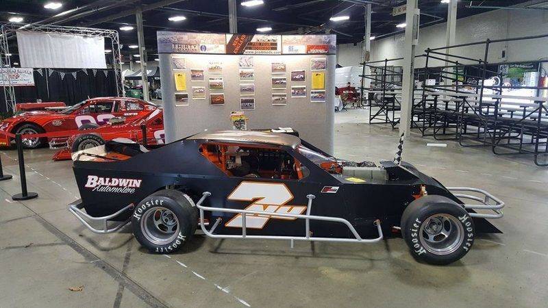

first time poster ,long time reader,im not and engineer ,but thirty plus years wrenching and building race cars,we race winged midgets on pavement,im building a new car fro my daughter,tired of running cookie cutter stuff,will be a wishbone rear susp with panhard bars,74 inch wheel base ,65 inches wide front and rear,56% left side ,I know you need more info,will supply as it comes,but my question is this,im going to run rear wishbones with torque tube,live axle,6 inch offset,most tracks 3rd mile or less slight bank,cars are 1100 lbs,400 hp,what is your advise on anti squat,(how much upward angle for rear wishbones,wheel travel runs about 3" at shocks,mounted on birdcages,also would jacobs ladders front and rear be a better choice(weve tried on last chassis,but she says she can't feel the car as well as with a panhard bar)sorry I am not supplyong as much info as you need,,,lmk how to help you,help me,,,thanks guys

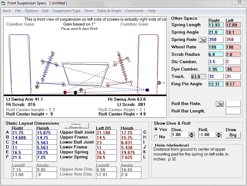

Ranger Mike,
I'm not at my shop but I believe we have about 2 inch difference in axels length , we only have a about 300 hp and the car weighs 1900lbs . I'm thinking that that would still apply to some point. One of the very accomplished chassis guy's I work with a lot likes to get as much weight up on the left front to keep weight on it so he's told us to move it in and back on his chassis's , I've always thought that might keep more weight on it through the turns. We've done very well with my boy's car and really haven't moved the left front as much as we have in my bigger car.
One other question or opinion I'd like to get is on the roll center in the little car I've got it to 2.2 right and 2.2 up with the spindles and upper mount we have, I can get it over more but then it migrates a lot to the right on drop, I believe it would be better not moving so much and leaving it were it is for now ? The roll center pic is close but not exact one the finale one is on my shop computer .
Thanks !

how much track width are you limited to? You have the exact tool you need to finalize the front roll center and migration. I plugged in your numbers and got closer tot eh 3 inch offset and kept migration under 4.5" by playing with the track width and left lower ball joint height. I increased it. You can do this by milling off the bottom of the spindle. Maybe " 0.050" and you can lower the top left ball joint height by milling off the top of the spindle. You are on the right track.

"Chassis Offset: The center of the chassis is measured between the front frame rails. All cars must have OEM type upper and lower ball-joints. Chrysler screw in, GM and Ford bolt in types are allowed. No spherical rod ends are permitted to replace ball joints. A maximum offset of 10 inches is allowed at the left side chassis rail. The inside of the left rear tire may not be any further to the right than the inside of the outermost left side chassis rail. The driver’s body must remain within the frame rails and the roll cage area. Door bars may not extend more than 6 inches outward beyond the outer frame rail. Maximum allowable track width is 76 inches, measured to the outer sidewalls of the tires."
I did fool around with the left side chassis height and got it to the 2.2 right / 2.2 up and very little migration.
I think I'll have to go with what you are suggesting to get it better. It's funny the Performance Trends software won't give me the camber gain on my laptop but works fine on the desktop at my shop,I may have to uninstall it then reinstall it's nice to have it at home to fool around with at night . Thanks again for the suggestions !

are you currently running 63 inch track width? can you increase this one both sides? can you add 2 inch to each side? remove 2 inch? what offsets are you running on the tires? what is rigth side tire width? offset? left side?
We do have track width at 76 , it comes out on software as 63 but because of the center of chassis to center of contact patch ( Hoping that is right?) I guess that measurment could be off a little and when I get back I'll double check it. , the offsets are 2 inch rights and 4inch lefts and we are at 60% left side weight which is limit.. wheels are 11inch with 10 inch wide tire ( or contact patch of tire) we do have 1/4 inch spacers we use to get maximum track if it needs to be adjusted but right now it's close .
go enjoy the tropics.. i will play around a little on software..i would rather have the RC work properly and nix little left side weight.

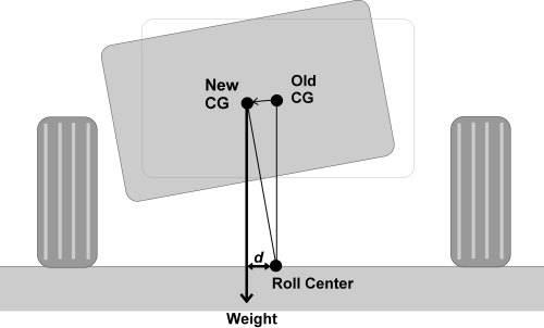

RC movement to the left or right will add downforce or take away down force on the right front tire. One inch migration will not hurt us and depending upon which way it goes may even help.The formula car we run has 2 inch RC height centerline and dropped to .9”, ran great.Assume a 2800 pound late model, 112” wheelbase, 66” track width, Center of Gravity (CG) = center of gravity and is 13” height.
If we have the Roll Center located in the centerline of the car, 66” track width, RC is 33” from each tire centerline.This 2800 pound car has 56% left side weight. Subtract the unsprung weight and we get 2100 pounds sprung weight. I am assuming things are pretty symmetrical so we will use 56% of this unsprung weight or 1,175#.If the RC was centered it would be located 33” from each front tire centerline and theoretically, we have ½ of the 1,175# or 587# left side sprung weight pivoting on the roll center and going to the right side slamming on the tire. (If the RC is located to the right by 3” we now have a lever between the RC to the tire centerline 3” longer on the left side and 3” shorter on the right side.
36/66= 55% so in effect we have increased lever by 5%. Now we have 55% of the left side inertia force thru the RC planting the right front tire.
55% is 646# so you get 60 # additional down force.Now add an inch of offset to the right 37/66= 56% and this adds 12 pounds. The point is we need to use body roll to create down force (not applicable on BBSS set ups). If we get too aggressive with the RC offset we start to lift the left front tire.So far this is all speculation. Let’s plug in some real numbers.
Weight Transfer due to body roll
First of all, by now, you know I hate the term “weight transfer” but since I poached the illustration off of http://www.autozine.org I will use it since they did a great job explaining it.In this example Weight is both sprung and unsprung weight.Lateral displacement of the CG is d. In this case, d = CG height in inches x sin of roll angle. Sin of 3° degrees is .052, sine of 5 ° is .088 sine of 10° is .173 and CG height is 13”If this racecar rolls over 3° we have .052 x 13 = 0.676Weight transfer to the outside wheel is (Weight x (RC location + d)) / track width2800# x (33” + 0.676) or 2800 x 33.676 = 94,29394,293 / 66” = 1,429# on outside wheelsCouple of things about this drill, folks. The Roll Center is assumed to be on the ground. Note the fact that we use the Sine of the angle of roll to find the additional length of the lever arm and add it to the RC to tire centerline lever length.Compare this to the Race car with centered roll center and no ° roll.2800 x 33 /66 = 1400 – conclusion, 3° roll gets you 30 pound down force, big deal (actually we should do the math right and figure exact RC location to get the true picture but hang with me here..)When we offset the RC to the right 3 inch and calculate
2800 x 36 / 66 = 1527 poundsAdd in 3° body roll and we get 1,555 poundsAdd 5° roll and we get 1,575#
Just for kicks that super dirt late model with 4 inch offset and 10 ° roll
2800 x (37 + (13 x .173)) = 2800 x (37 + 2.49) = 2800 x 39.49= 1,675#
What this tells us is the Roll Center location is important. One inch movement won’t hurt too much.

Great explanation and example. I can now use this to understand what happens with my car. Thanks for the awesome info.
thank you Drobbie, all you all can figure it out as i got a lot of it from books and web sites. I just cut some corners and brought it to you a little quicker.
