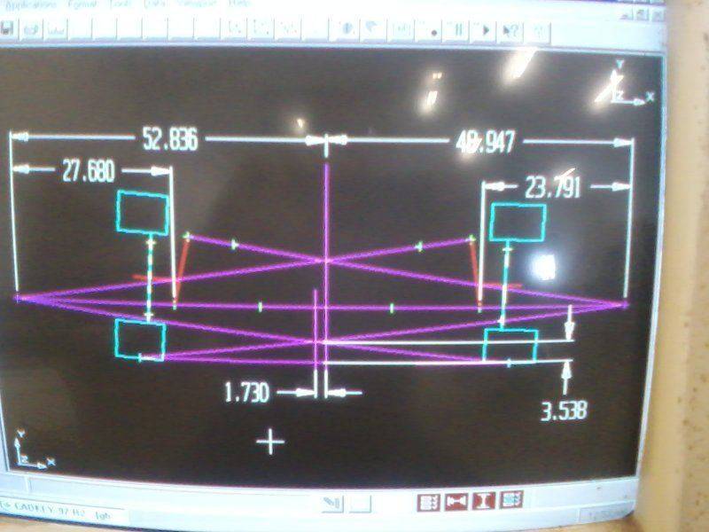

So the roll center-to-contact patch has an ideal angle? is 45 degrees the best combination of lateral and vertical loading ?
Saturday night duck walk - why RC location matters
Thanks Willy...a 45 degrees angle between RC and tire contact patch would place the RC centered on the right front grease zerk of the right lower ball joint. You would have maximum jacking effect and you would lift the left front tire thru the turns and overload the right rear tire...like the old sprint cars used to do..classic ..but wears out the rt rear quick.
This would permit air to get under the front end and defeat the aero down force which is what the BBSS ( big bar soft spring) set up is all about.
If we are running a traditional set up and not the BBSS set up we want a balance of placing the RC so it loads the right front tire without jacking the right front.
We want the RC as low as possible to kill of the jacking effect and minimize camber build yet...plant the right front using body roll without lifting the left rear tire.
On dirt tracks we want even more RC offset was we are dealing with a slick track 75 % of the time ( dirt track goes thru 4 phases from slurry slick to hard packed over the course of the night depending upon how the track owner maintains the racing condition). That’s why you see the super late model dirt cars really twisting the body. They set up for slick and when the track dries and gets hard the cars really hook up toward the end.
Pretty much a balancing act.
My point is that you should know where the RC is and understand what happens when weight is transferred in a turn. If you do this, your chances of making correct changes on the set up at the track are a lot better. If you get the RC close, then chance are you can bring in the balance with ARB (sway bar) tuning, J-bar, shock, stagger and wedge adjustments.

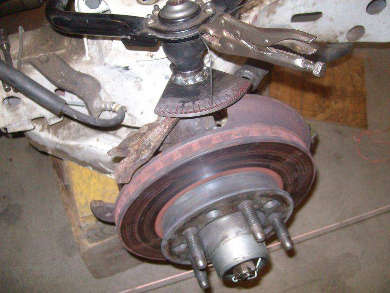

Just read all 31 pages in this multi-year old thread. Signed up for a physics forum with no real interest in physics outside of making my race car faster...

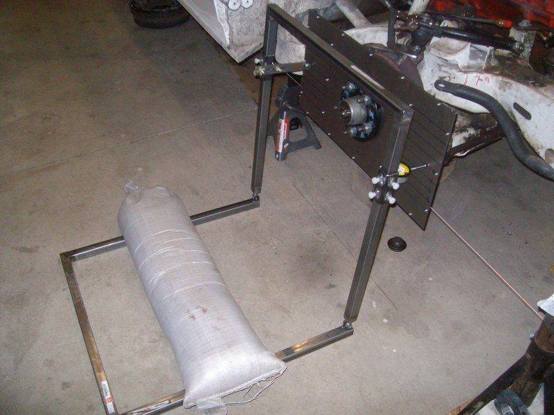

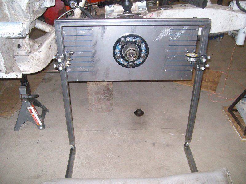

And to say thank you for all your time in effort. How would you go about benchmark this front suspension?
Thank you and I am sure the other folks who have contributed to this discussion thank you as well..ref: bench marking stock suspension...if there is a way you can drive the car onto a full ramp lift ( the kind you drive on like those in muffler shops) and raise it..you can better measure the various mount points with car in normal ride height postition.
Alternative is to use jack stands and map the mount points as best you can then drop the car to normal ride height and try to get the outer BJ dimensions...
it is very difficult to do this wit hengine and all the shrouding in place...obviously..
What would be the upper "ball joint" point? The pivot point between pieces 6 and 5 referencing my previous picture? Does piece #6 move?
Here are some other pics to help.
http://images.rvsmods.com/var/albums/Cars/SR20/Suspension/P11%20vs%20B15%20Front%20Suspension.JPG?m=1342499417
(on the left)
http://images.rvsmods.com/var/albums/Cars/SR20/Suspension/P11%20Multilink%20Tunring.JPG?m=1342499423
EDIT: Did some more research, apparently the upright "third link" stays stationary as the wheel is turned.
So we have a rotation point on the top of the spindle and then two pivot points above that.
You are correct on upper Ball Joint at end of the strut..

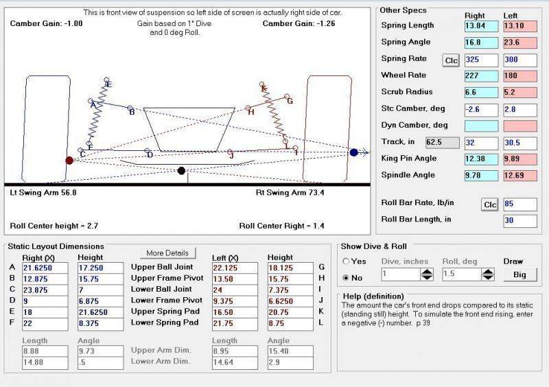

Any good software suspension program should cover mcpherson strut design like you got. I hate these for racing purposes but you can trick them out.
Btw this isn't a strut design. The green, aftermarket piece in the top picture is a strut, but I am referring to the stock pieces. They are for two separate cars.
Once I get further along into my build I will report back with the bench marked front end.

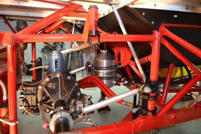

Ranger Mike...First of all I love reading all these posts & the help you have been offering us racers!
On your last posts I noticed you said you like to minimize things like bump steer, rear steer, & camber build...we run 4 link modifieds on dirt and we have been playing with cutting back on rear steer. Other than trial & error is there any info out there on evening out rear steer
Missile07 --Thanks for the kind words..pls. see post # 116 on page 8
When using a very trick 4 link rear suspension using roll over steer adds a big advantage on the dirt track surface. It allows the rear to roll into the corner without breaking traction. To review, when the rear rolls, if the outside wheel base grows longer than the inside wheel base we have roll over steer. This is because of the different in 4 link angles. I think if you start with left upper link at 13 degrees uphill, the rt upper link at 17 degrees uphill, and both lower links at 5 degrees down hill, it is a good base line. Make sure the rear end is straight and has not become bent thru wrecks and crashes.
We have been trying to figure out a way to properly measure at full drop the difference in the right & left. At full drop the left side is leading 3.5 inches more than the right. For the past couple of race nights we have shortened the right side bars up to 1 inch. Driver seems to think its helping him from the center off...but I am almost convinced that this is a band aid fix for something else.
i am n Kentucky today...will be back at home base tommorow. I think you have a roll understeer at center off. I agree that there could be something else off. Is is possibel to post the rear end settings on the 4 links?

Bar lengths
LR top 16"
LR bottom 12"
RR top 16" shortened to 15.75"
RR bottom 12" shortened to 11.75"
Bar Angles @ Ride Height
LR top 24-26 degree (chassis manufacturer recommendation)
LR lower 5 degree
RR upper 18-20 degree
RR lower 0-2 degree
As far as the wheel rates I would be lying if I said an exact number but he was running 120 lbs of LR bite & about 55% rear. The last night we were able to race I did pyro the tires and the RR was about 10-15 degrees hotter on both of the final two runs. Car hasn't finished out of the top 5 since June but just missing something.
not having my notes with me, i think you got just a tic too much roll understeer. My guess is to take 2 to 3 degrees out of top right upper link and read tires..if the temp drops a few degrees and car is better...may have found some of the problem...small changes ...dont do anything dramatic...

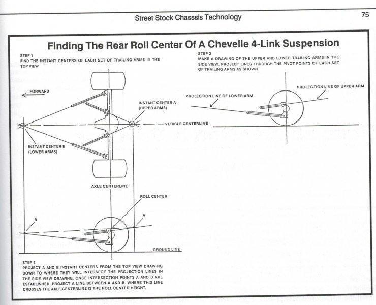

we went thru this on page 26 of this forum with a fellow running a drawf car...wider is better in that you have more cornering ability in that for a given set up you will transfer less weight and the tires can better accommodate the weight that is transferred. Also the Left rear to right front leverage is improved slightly...and thus side bite off the turn with a tad more wedge..read the whole page as we had a good debate on this...
General Rule of thumb - 1 inch lower COG transfers 3 to 4 % less weight. 1 inch wider car transfers 1 to 1 1/2 % less weight.
Assume we have a race car with 66 inch wide rear track and we add 100 weight to the ballast and we locate this weight 20 inch from the center line of the left rear tire. 20" divided by 66" = 37% of the added weight will go to the right and 63 % will go to the left side of the car ( diagonal weight is not in this calculation). Now if we increase the track width on t he left side by one inch we have 21" divided by 67" = 31% right side weight and 68 % left side weight. (from Short track chassis set up by Duke Southard)
