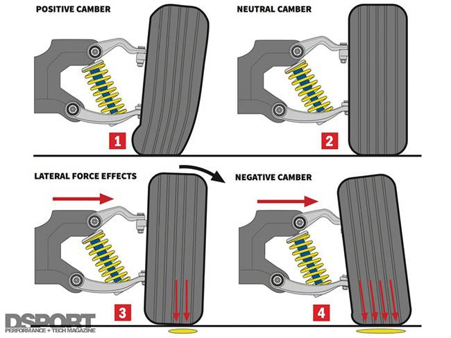

Rear axle camber bending on stock rear ends.

You can run up to about 1/2 degree of negative camber in a Ford 8.8, Ford 9 inch non floater, and a Chevy 12 bolt by bending up the rear axle tubes with a little heat from a torch. A sharp axle guy can take the end off the tube and reweld it at a very slight different place higher on the tube than before and with a little angle to it. I have seen a Ford 9 in a Camaro Stock class that ran for 8 years with a little more than 1/2 degree of negative camber and the axles looked like new. The inner splines can take that much mis-alignment and there can be that much just in production tolerances. SCCA allow that much negative in American Sedan and American Iron and most guys put that much into the rear ends without wearing them out at all. To get more than that in a floater or non-floater you need to have the axle splines machined in a slight barrel shape which allows them to flex inside the splines at a larger angle. It doesn't take much.

  • Four-panel diagram of a car wheel viewed from the front showing camber: 1 positive camber, 2 neutral camber, 3 lateral force effects under load, 4 negative camber. Red arrows show force on the tire contact patch.

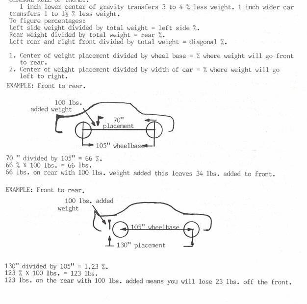

You could take 106# off the front and put it in the rear. But, Duke Southard wrote his book, Short Track Chassis set-up and had this nugget of information.
You do not need to go crazy on frame modification to get 48% rear weight. Note where the battery, fuel cell and ballast weight is now and do some calculations.
  • Hand-drawn notes on weight transfer for a race car: center of gravity and wheelbase formulas, plus two car diagrams showing 100 lb weight added at rear with 70 inch and 130 inch placements.
