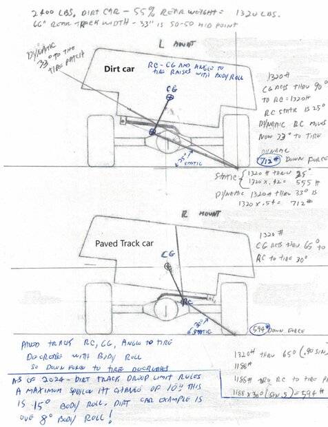

I been doing some studying on the situation. Your dirt car set up now works so I would not change anything.
When you throw it into the turns the body does major roll and does three things..
plants a lot of left rear weight on the right front
shifts right rear weight to the right front
rolls a lot of that left front weight onto the right front.
This all goes out the window if you run the current BBSS setup Big Bar Soft Springs. Proponents of this setup want minimal body roll so the bottom of the car will seal up with a smooth track to cause downforce. On paved tracks the panhard bar or J bar is mounted to the chassis on the right side and the rear end on the left side. The Roll Center and CG move very little during body roll and actually lowers as the body rolls! This reduces the angle of the force going to the tire patch and thus reduces the tire downforce on the right rear tire. Even traditional paved track set ups had very little roll, a few inches shock compression and little left side droop. Paved track cars mount the J bar on the right rear chassis to kill off tire loading of the right rear. If they used the dirt track mount ( left side chassis mount) the right rear would be too loaded and PUSH.
You get an idea by looking at the crude pic I attached. The dirt set up left side chassis mount has almost a 90 degree lever from the CG to the roll center ( J bar roll center is the mid-point between the mounting points). As the dirt car body rolls, typically 4 inch left side droop and 3 to 4 inch right side compression, the CG and Rc raise up. The angle of the RC tot he right side tire patch increases as does the downforce. You would burn the right rear tire if this was the paved track setup!
Revised in March 2024 - years after I first wrote this post.
Here is why dirt track cars mount Panhard bar to chassis on left side. More right rear load on tire patch. Paved car may roll 4 degrees but that honking dirt late model body rolls 15 degrees
it looks like the angle of the bar in right roll is what is making the difference in the amount of jacking effect due to lateral accelleration, and the fact thet the axle attatchment point is on the right side is actually counterproductive as this applies more of the force to the outside wheel. If the bar were mounted to the right side of the chassis, but lower than where it is mounted to the axle on the left side of the axle, the jacking force could be maximized for the inside tire, which needs al the help it can get. of course, the roll center for the chassis needs to be fairly high, I would assume to maintain a front down sloped roll axis and allow soft springs without using an overly stiff sway bar, and unloading the inside tire too much with the sway bar. so, maybe a bracket could be made to lower the chassis Jbar mount on the right, and a bracket attatched to the axle to raise the Jbar the same amount on the axle, creating the same jacking force as the Jbar mounted to the left side of the chassis.
This is just theory to play with, I am not making any recommendations based on experience here. Like I said, I don't quite get dirt. I am trying to learn about all forms of racing suspension, though, because that is the best way to stay on top of the type you are in to.
oh, also the jacking force would actually pull the rear of the car down, not force it upwards, with the Jbar mounted as descrided above. so I guess that would be a negative net jacking force on the chassis, while still having a net downward force at the axle. Of course the point at which the force vector(which is more lateral than vertical is applied at a higher point on the axle, so the torque with which it affects right rear loading more than left rear may cancel out the benefit of it being more to the left. But, why not make it a little longer. You would decrease the downward component of the jacking force, but it would be applied more evenly across the rear tires.
Yes Autodoc911
you are correct in that different mounting will change the angle..my point was to show the differences..and you can see the jacking effect when the body hikes up so dramatically..

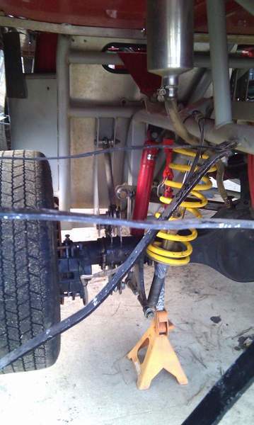

Squaring my car !
Whats the best sure fire way to square all 4 wheels of my car
too many times i find chassiss tabs to be out resulting in a poor reading
i guess there only as good as the guy putting them on!
Thanks smokin
String it..old as the pyramids but it works.. Set 4 jack stands on the floor and run string to each leaving the front open. You will be rolling the car into the U and running the front string after the car is in place. It is much easier to check the diagonal measurement to confirm square when car is not in the string U.
Disconnect panhard bar before you check for square. Another check would be to make sure the rear end is not bent. Scribe a line on each rear tire, all tires in fact as it will make things easier. Measure the rear track width every 90 degrees and if you have deviation, the wheel or rear end is bent.
I use plumb bobs to assist in this. I put masking tape on the garage floor and use a felt tip marker to id. the plumb bob touch point. You get the idea. cheap , an pain in the A to set up but it works pretty good. sometimes simple is best.
