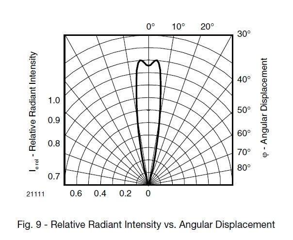

According to the datasheet: "Angle of half intensity: φ = ± 10°", corresponding to 0.38 sr. For more specific calculations, you need a better sense of how the intensity is distributed in angle, but 55 mW total radiated power seems reasonable.
So is it safe to assume that almost all of this this 55mW is radiated in an Angle of half intensity then ?
Definitely not- the angle of half intensity is conceptually similar to a 'full width- half maximum' specification. Light is emitted outside of the ± 10° cone angle.
Andy is right. It's not safe to assume that almost all of the power is emitted in the angle of half intensity. However if you look at the plot for the VSMY2850 it's perhaps not unreasonable in this case. Depends how accurate you need to be.
Ok, so this LED has 55mW Total radiant power (typical).
From the plot I can see that for relative intensity values > 0.1 the whole plot is within 20° half angle,
can I now assume that 90% of emitted 55mW is within 20° half angle ?
Is it then correct to say that within 10° half angle the emitted power will be 50% of the 55mW ?
It's a long time since I did this but if my memory is correct it's the volume under the curve that matters. Volume not area because the curve is actually in 3D. For example to calculate the power within the 10 degree half intensity you have to compare the green volume with the red volume. So in this case it looks like a very high percentage is emitted within the half intensity angle. Safe to assume near 100% I'd say (especially if you take into account the tolerance of the power output?)
If someone knows better let me know!

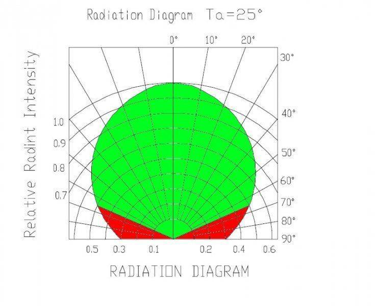

For this LED it might not be safe to ignore the power outside the half intensity angle...
CWatters, thanks a lot for the pictures, I think I can now understand the relationship between the half intensity angle, the total power and how to read out where I can find that power from the radiation pattern plots of the LED's.
Now, I just need to connect this with Radiant intensity.
