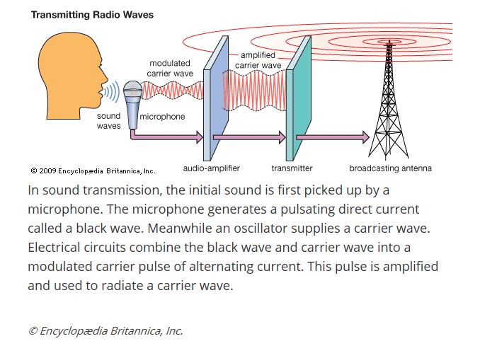

Ok let's take this explanation for example http://kids.britannica.com/students/assembly/view/53879
I think I understand the first part correctly where audio sound waves are converted into electrical signals by the function of electromagnetism but after that I have no idea what is happening.
"In sound transmission, the initial sound is first picked up by a microphone. The microphone generates a pulsating direct current called a black wave. Meanwhile an oscillator supplies a carrier wave. Electrical circuits combine the black wave and carrier wave into a modulated carrier pulse of alternating current. This pulse is amplified and used to radiate a carrier wave."
I have problem understanding these parts "Meanwhile an oscillator supplies a carrier wave." and "Electrical circuits combine the black wave and carrier wave into a modulated carrier."
Also why do they always say "Modulated" instead of Modified? Isn't it the same thing?

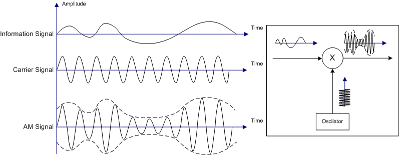

The page that you linked to is about amplitude modulation. Here's a diagram from the Wikipedia article about amplitude modulation that shows the concept more explicitly.
Three stacked graphs of amplitude against time: an information signal, a sinusoidal carrier signal, and the resulting AM signal with dashed envelope lines, plus a block diagram of a multiplier mixing the information signal with an oscillator output.
"Modify" means to make any change. "Modulate" has a more specific meaning in this context: to modify some property of the carrier signal so that it varies in step with the information signal. Here, the property of the carrier signal that's being modulated is its amplitude.
The other two fundamental properties are a wave are its frequency and its phase. Each of these can also be modulated to carry information. Google for "frequency modulation" and "phase modulation" for more information on Wikipedia and elsewhere.
Flow diagram titled Transmitting Radio Waves: a head speaking, sound waves reach a microphone producing a modulated carrier wave, then an audio-amplifier, an amplified carrier wave, a transmitter, and a broadcasting antenna radiating red concentric waves.
That's got to be about the worse description I have ever seen and bears little resemblance to reality
no wonder you are confused
Black Wave ? really ? I have been doing radio transmission stuff for 40 yrs and have never heard that term ... IT IS BAD and incorrect
It is more correctly called an audio signal
There is No Carrier Wave till the transmitter stage. The transmitter stage produces a carrier wave that is MODULATED by the audio signal
That modulated carrier wave is then sent to the antenna for transmission
I think it should be a general principle to avoid 'Encyclopaedia' articles about anything but pure facts (dates, names etc). Electrical Engineering (and any of the Sciences) will not be well supported by the small number of staff who are involved in getting an A toZ compendium of info. I used to look at Britannica in our Department library, occasionally and it was often in subtle (or even total) disagreement with textbooks and research papers.

I just looked at the Britannica diagram. It's total garbage. It shows an amplitude modulated carrier wave coming out of the microphone. The so called "black wave" refers to the black envelope of the AM signal in the diagram I think. Shocking!
yeah, as I said way up the thread where I reproduced the diagram
