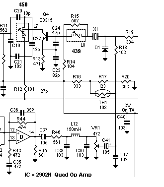

here's a simple example a part circuit of a bit of gear I work on
Partial schematic of a radio transmitter circuit showing crystal X1, varicap diode D1, transistor Q4 (C3316), inductors L7 and L8, and an IC labelled 2902N Quad Op Amp with a 3V On TX supply.
The audio comes via the Op-Amp (lower right) through VR1 (modulation level adj) up through R18 to the top of D1 and the crystal X1
The diode is a varicap diode ( also known as varactor diodes) it's capacitance varies with the voltage ( the audio signal) applied to it
This varying capacitance causes the crystal oscillator to vary in sympathy with that changing capacitance ... and so an FM signal is produced
There are other systems used to produce FM and all the other modulation types
Where an FM signal is usually produced at the oscillator end of the transmitter line-up, an AM signal is produced when the audio is added (usually) to the final output stage of the transmitter (unless the final stage is a linear amplifier, then the audio will be added to the driver stage)

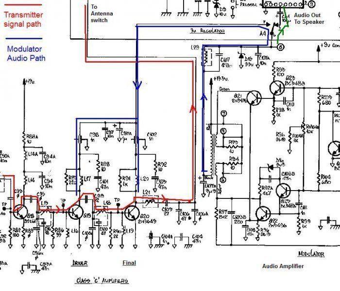

Also found an old commercial AM radio I used to work on shown is just the modulator and the TX output
I have added some colour tracing to see the signal paths. in this example both the driver and final transistors are modulated
Schematic of a vintage AM transmitter with colour tracing: red arrows show the RF signal path through the driver and final stages, blue arrows show the modulator audio path to the 9V regulator and audio amplifier.
AM transmitters are very power hungry. In the above its a 10W RF transmitter and that needs a 10W audio amplifier for the modulator
as the RF power increases, so does the size of the audio amplifier
From the 2 circuits I have shown, you should be able to grasp the difference in FM and AM modulation
FM ... the transmitter carrier frequency is being slightly varied
... The carrier amplitude is constant but the freq varies
AM ... the power supply rails to the driver and final transistors is being varied causing a variation in the transmitter power output ( its amplitude)
... The carrier frequency is constant but the amplitude varies

Could someone also clear one other thing up. When you send the signal you want transmitting to an antenna for example, does the antenna convert the signal into an EM wave that is mixed with a separate carrier wave (i.e. you have two EM waves being generated and then mixed) or is it just one EM carrier wave that it generated which has the signal encoded on it.
Have a look again at the AM transmitter in my post, post #6 everything in that red line is EM ie. an RF signal
The Antenna is just a bit of open transmission line that is tuned to the frequency the transmitter (and receiver) is working on so it efficiently radiates
that EM ( RF) signal
Look again at both diagrams and see where I explained that the modulation signal and the RF signal are mixed :)
