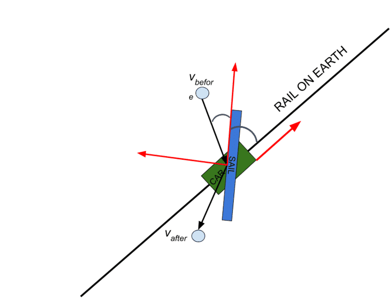

The particle hits the sail which is installed on the rail car. Particle mass and velocity car mass is given in 2D. What would be particle and car velocities after collision?
$$ m_p\vec{v}_p^0 = m_p\vec{v}_p^1 + m_c\vec{v}_c $$
$$ \frac{1}{2}m_p\left \| \vec{v}_p^0 \right \|^2 = \frac{1}{2}m_p\left \| \vec{v}_p^1 \right \|^2 + \frac{1}{2}m_c\left \| \vec{v}_c \right \|^2 $$
$$ m_p<\vec{v}_p^0, \vec{n}> = m_p<\vec{v}_p^1, \vec{n}> $$
I solve the following problem, there is a particle of mass ## m_p ## and velocity ## \vec{v}_p ## which collide with sail installed on rail car with mass ## m_c ## resting in the frame of reference associated with it before the collision. The cart is fixed on straight rails for which the vector ## \vec{n} ## is normal. All velocities are given for the inertial frame of reference associated with the cart before colliding with a particle
Diagram of a rail car with a sail on a straight rail labeled RAIL ON EARTH, showing the particle velocity v_before arriving and v_after leaving, with red arrows for velocity components and angles marked at the sail.
I wrote down three equations, two general ones and the last equation taking into account the orientation of the rails
First equation for moment conservation, which is always the case
## m_p\vec{v}_p^0 = m_p\vec{v}_p^1 + m_c\vec{v}_c ##
Next energy conservation
## \frac{1}{2}m_p\left \| \vec{v}_p^0 \right \|^2 = \frac{1}{2}m_p\left \| \vec{v}_p^1 \right \|^2 + \frac{1}{2}m_c\left \| \vec{v}_c \right \|^2 ##
And third one is equation which say that in the normal to rail direction moment of particle is conserved after collision
## m_p<\vec{v}_p^0, \vec{n}> = m_p<\vec{v}_p^1, \vec{n}> ##What is the difficulty ?
The point is that I do not understand how to write the equation taking into account the orientation of the sail, although it is obvious that the orientation of the sail is determining for this task, just like the orientation of the rails, but for the rails I seem to have written the equation, but for the sail I don’t know how.
Momentum will not be conserved in the direction normal to the rails.
Why?
Why?
My thoughts were the following:
I took momentum conservation equation:
then I made a scalar product for both sides of it
## <m_p\vec{v}_p^0, \vec{n}> = <m_p\vec{v}_p^1 + m_c\vec{v}_c, \vec{n}> ##
simplified it a bit
## m_p<\vec{v}_p^0, \vec{n}> = m_p<\vec{v}_p^1, \vec{n}> + m_c<\vec{v}_c, \vec{n}> ##
and then I realized that ##<\vec{v}_c, \vec{n}>## must be equal to zero because car can't have any velocity in the direction of ##\vec{n}##
So finally I get my third equation
It seems "not OK" for me also because it turns out that the particle did not collide with the car at all. But I can't figure out what is wrong with these calculations above. And if you have ready to show equations for this task, I will be very grateful for that.
As I posted, that is not applicable. There is a reaction impulse from the rail.
Only the component of momentum parallel to the rail will be conserved.
What is "reaction impulse"?
Could you please kindly write some equations? Or maybe you provide links to some motivational examples similar to my case?
The impulse of the normal force from the rail . According to one model, this impulse completely neutralizes any possible component of velocity normal to the rail, after the collision.
That is the normal component of velocity after collision is zero for all the bodies of interest.

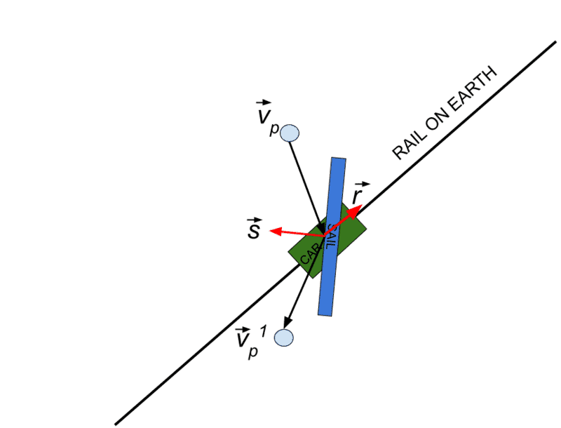

I finally have the solution (whether it is correct or not, I expect you to judge)
Given:
##\vec{v}_p## and ##m_p## initial velocity and mass of particle.
##m_c## is the mass of car which is on rail with unit vector ##\vec{r}## direction and unit (with length equal to 1) vector ##\vec{s}## as sail perpendicular vector
Task: is to find ##\vec{v}_p^1## and ##\vec{v}_c## (because initial is zero). Frame of reference is stick to car for simplicity.
1. Momentum conservation equation particle velocity divided into 2 parts parallel to ##\vec{s}## and perpendicular.
##m_p(\vec{v}_{p\parallel s} + \vec{v}_{p \perp s}) = m_p(\vec{v}_{p\parallel s} + \vec{v}_{p \perp s}) + m_c\vec{v}_c##
2. I claim that perpendicular to ##\vec{s}## part of particle velocity will remain the same after collision
##\vec{v}_{p\perp s} = \vec{v}_{p\perp s}^1##
3. Considering (2)
##m_p\vec{v}_{p\parallel s} = m_p\vec{v}_{p\parallel s}^1 + m_c\vec{v}_c##
4. Energy conservation equation (collision is rigid)
##\frac{1}{2}m_p\left | \vec{v}_p \right |^2 = \frac{1}{2}m_p\left | \vec{v}_p^1 \right |^2 + \frac{1}{2}m_c\left | \vec{v}_c \right |^2##
5. Trtansform (4)
##m_p\left | \vec{v}_p \right |^2 - m_p\left | \vec{v}_p^1 \right |^2 = m_c\left | \vec{v}_c \right |^2##
##m_p(\vec{v}_p - \vec{v}_p^1)(\vec{v}_p + \vec{v}_p^1) = m_c\left | \vec{v}_c \right |^2##
6. Membering (2) perpendicular part of particle velocity after the collision is the same
##m_p(\vec{v}_{p \parallel s} - \vec{v}_{p \parallel s}^1)(\vec{v}_{p \parallel s} + \vec{v}_{p \parallel s}^1 + 2\vec{v}_{p \perp s}) = m_c\vec{v}_c\vec{v}_c##
7. Considering (3)
##m_p(\vec{v}_{p\parallel s} - \vec{v}_{p\parallel s}^1) = m_c\vec{v}_c##
##\vec{v}_{p \parallel s} + \vec{v}_{p \parallel s}^1 + 2\vec{v}_{p \perp s} = \vec{v}_c##
8. I claim that parallel to ##\vec{s}## component of particle velocity perpendicular to ##\vec{r}## is remain the same after collision
##\vec{v}_{p \parallel s \perp r}^1 = \vec{v}_{p \parallel s \perp r}##
Proof:
Consider momentum conservation equation:
##m_p\vec{v}_{p \parallel s} = m_p\vec{v}_{p \parallel s}^1 + m_c\vec{v}_c##
then consider it in two parts: perpendicular to ##\vec{r}##
##m_p\vec{v}_{p \parallel s \perp r} = m_p\vec{v}_{p \parallel s \perp r}^1 + m_c\vec{v}_{c \perp r}##
but ##\vec{v}_c## can not have any perpendicular to ##\vec{r}## component thus proof is ended
##m_p\vec{v}_{p \parallel s \perp r} = m_p\vec{v}_{p \parallel s \perp r}^1 + m_c\vec{0}##
9. Consider parllel to ##\vec{r}## particle
##m_p\vec{v}_{p \parallel s \parallel r} = m_p\vec{v}_{p \parallel s \parallel r}^1 + m_c\vec{v}_{c \parallel r}##
substitute ##\vec{v}_c## from (7) (##\vec{v}_{c \parallel r}=\vec{v}_{p \parallel s \parallel r} + \vec{v}_{p \parallel s \parallel r}^1 + 2\vec{v}_{p \perp s \parallel r}##)
then
##m_p\vec{v}_{p \parallel s \parallel r} = m_p\vec{v}_{p \parallel s \parallel r}^1 + m_c(\vec{v}_{p \parallel s \parallel r} + \vec{v}_{p \parallel s \parallel r}^1 + 2\vec{v}_{p \perp s \parallel r})##
10. Finally we got answer for ##\vec{v}_{p \parallel s \parallel r}##
##\vec{v}_{p \parallel s \parallel r}^1 = \frac{m_p-m_c}{m_p + m_c}\vec{v}_{p \parallel s \parallel r} - \frac{2m_c}{m_p + m_c}\vec{v}_{p \perp s \parallel r}##
11. Using same logic we can get ##\vec{v}_{c \parallel r} = \vec{v}_c##
##\vec{v}_c = \vec{v}_{c \parallel r} = \frac{2m_p}{m_p + m_c}(\vec{v}_{p \parallel s \parallel r} + \vec{v}_{p \perp s \parallel r})##
PS
What is for example ##\vec{v}_{p \parallel s \perp r}##
##\vec{v}_{p \parallel s \perp r}=\frac{<\vec{v}_p,\vec{s}>}{\left | \vec{v}_p \right |\left | \vec{s} \right |}\frac{<\vec{s},\vec{r}_{\perp}>}{\left | \vec{s} \right |\left | \vec{r}_{\perp} \right |}\vec{r}_{\perp}##
I have already explained twice that this equation is wrong. It ignores the reaction from the rail. Write the equation for conservation of momentum in the ##\hat r## direction only.
I really do not know what that extended subscript notation means. Is it standard?
Would ##\vec v_{\parallel x\parallel y}## mean ##(((\vec v.\hat x)\hat x).\hat y)\hat y##?

Delta2 said:
In my opinion it is the parallel to s component of the velocity of the particle that remains unchanged
@MaratZakirov defined ##\vec s## as normal to the sail. Does that change your view?
Yes ok then it is the normal to ##\vec{s}## component that is conserved. (assuming no friction).
haruspex said:
I have already explained twice that this equation is wrong. It ignores the reaction from the rail. Write the equation for conservation of momentum in the ##\hat r## direction only.I really do not know what that extended subscript notation means. Is it standard?
(I tried to edit my answer, but now I can not, so I make this post)
Yes, I agree, but I view on this in slightly different angle. Conservation of moment is always the case but in te ##\vec{v}_{p \parallel s \perp r}## direction there will be interaction with the planet Earth itself, so I claim that
##\vec{v}_{p \parallel s \perp r}^1 = -\vec{v}_{p \parallel s \perp r}##
do you agree?
Also (I must correct myself) remembering that ##\vec s## and ##\vec r## are unit vectors
##\vec{v}_{p \parallel s \perp r}=<\vec{v}_p,\vec{s}><\vec{s},\vec{r}_{\perp}>\vec{r}_{\perp}##
where ##\vec{r}_{\perp}## are perpendicular (any of two actually) to ##\vec r## unit vector
and <a, b> are obviously scalar product between ##\vec a## and ##\vec b## vectors. I do not know whether it is a standard notation or not, for me, it's pretty usable and as hope correct. My answer to your second question is yes, I meant exactly that.
MaratZakirov said:
so I claim that
do you agree?
I see no reason to suppose that.
Consider the case where the particle strikes the sail square on. Your claim becomes
##\vec{v}_{p \perp r}^1 = -\vec{v}_{p \perp r}##.
I would claim that in this square on case the particle bounces back along the same line, so the ratio of ##|\vec{v}_{p \perp r}|## to ##|\vec{v}_{p \parallel r}|## is unchanged. It follows from those two that ##\vec{v}_{p}^1 = -\vec{v}_{p}##, which is clearly false.
What you do have is
- conservation of momentum of particle parallel to the sail
- conservation of momentum of particle + cart parallel to the rail
- conservation of energy
and three unknowns
- final speed of cart
- final speed and direction of particle
There is no need to introduce any doubtful claims.

haruspex said:
What you do have is
and three unknowns
Exactly this. And for heavens sake use the simple and obvious coordinate system with the rail stationary and on the x-axis, then you can remove all the ## \parallel ## and ## \perp ## subscripts and just talk about e.g. ## v_{px} ## as the velocity of the particle parallel to the rail, and lots of terms disapper because you know that e.g. ## v_{cy} = 0 ## always.
(Edit: note that I referred to 'coordinate system' above rather than 'frame of reference' because I don't think you understand what that term means: in the FoR of the car the velocity of the car is always zero, by definition).
Please prove your statement, it is totally not obvious to me.
But I agree that fewer claims is better, so let's write equations without it:
1. Momentum conservation parallel to sail (no friction with sail)
##m_p\vec{v}_{p \perp s} = m_p\vec{v}_{p \perp s}^1##
2. Momentum conservation along rail
##m_p\vec{v}_{p \parallel r} = m_p\vec{v}_{p \parallel r}^1 + m_c\vec{v}_c##
3. Restricton
##<\vec{v}_c, \vec{r}_{\perp}> = 0##
##m_p\left| \vec{v}_p \right|^2 = m_p\left|\vec{v}_p^1\right|^2 + m_c\left|\vec{v}_c\right|^2##
Do you agree with these 4 euations?
I completely miss your point (https://en.wikipedia.org/wiki/Inertial_frame_of_reference)
pbuk said:
Exactly this. And for heavens sake use the simple and obvious coordinate system with the rail stationary and on the x-axis, then you can remove all the and subscripts and just talk about e.g. as the velocity of the particle parallel to the rail, and lots of terms disapper because you know that e.g. always.
I do not see anything simple in simultaneously using two coordinate systems, one tied to the sail and other to the rail.
A solution in a system with a rail at rest must be obtained in a trivial way after this problem is solved.
MaratZakirov said:
Yes, it is clear that you are missing the point so I will repeat it: the car/sail is not an intertial frame of reference because it is being accelerated by the particle and the rail.
Nobody is suggesting two coordinate systems. Just use one that is not being accelerated i.e. the rail.
No, if you do manage to get a set of equations that work in the non-inertial frame of the sail/car then transforming them back into an intertial frame is not trivial.
There's no point asking for help in a forum and then ignoring the help you are given.
pbuk said:
Yes, it is clear that you are missing the point so I will repeat it: the car/sail is not an intertial frame of reference because it is being accelerated by the particle and the rail.Nobody is suggesting two coordinate systems. Just use one that is not being accelerated i.e. the rail.No, if you do manage to get a set of equations that work in the non-inertial frame of the sail/car then transforming them back into an intertial frame is not trivial.
Let's separate the patties from the flies.
The inertial frame of reference associated with the car before the collision is not accelerate. After the collision, the car will have a velocity different from ##\vec{0}## in this system.
Maybe you want to say that:
a) I didn't write equations correctly. (if so why?)
XOR
b) I can't write them correctly due to high complexity of case when I stick to car before collision. (if so why?)
