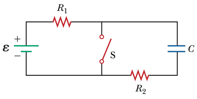

In the diagram below, the switch S has been open for a long time. It is then suddenly closed. TakeEe = 10.0 V, R1 = 50.0 kΩ, R2 = 100 kΩ, and C = 10.0 µF. Let the switch be closed at t = 5.0 s. Determine the current in the switch as a function of time.
I(t) = -I/RC * e^(-t/RC)
After the switch is closed, current flows clockwise from the battery to resistor R1 and down through the switch.
I don't understand the reasoning for the following: the current from the capacitor flows counterclockwise and down through the switch to resistor R2. How do I determine the direction of current when a capacitor is charging? Thank you.
This capacitor is fully charged when the switch is closed. At that point the battery is effectively disconnected from the capacitor and the capacitor discharges through ##R_2##. Are you asking about a different problem?
