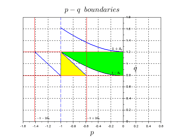

Note from $(3a)$ and $(1)$, that $p$ is restricted to the interval $-1 \leq p \leq 0$. We can graphically illustrate the set of possible solutions:
Only $(p,q)$-pairs in the intersection of the yellow and green sets are allowed. Thus only the o-marked corner point at $(-1,1+\delta_0)$, is a valid solution. Indeed, the lower limit in $(3a)$ intersects the upper limit in $(2a)$ in $p = -1$:
\[\sqrt{1+(-1)^2}-\delta_0 = \delta_0 - (-1) \Rightarrow \sqrt{2}-\delta_0 = 1+\delta_0\Rightarrow 2\delta_0 = \sqrt{2}-1 \Rightarrow \delta_0 = \frac{\sqrt{2}-1}{2}\;\;\;\;TRUE\]
We can conclude, that $(p,q) = \left (-1, \frac{\sqrt{2}+1}{2} \right )$ is the only solution.
