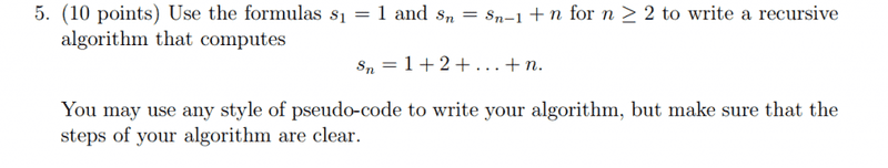

The discussion revolves around a recursive algorithm intended to compute a sum defined by the recurrence relation S_n = S_{n-1} + n, with initial conditions provided for S_1 and S_2. Participants are exploring the correctness of the algorithm and its implementation, particularly in the context of handling different values of n.

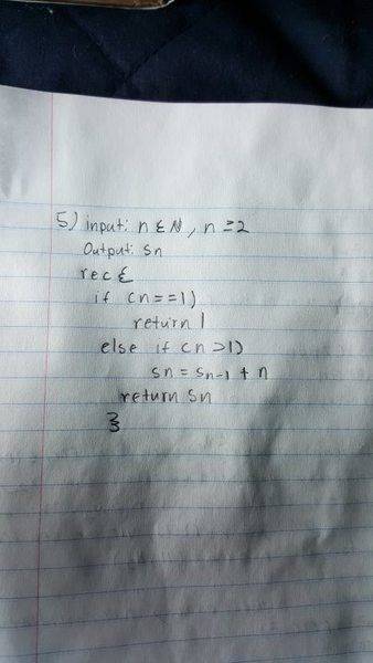

I feel like you might want to use a for loop for this... something like:
S=1
for x = 2 to n
build the sum
Return to sum of n terms.

On the last line, the part in parentheses is Sn - 1 + n. I'm sure this means ##S_{n - 1} + n##, but it looks more like S times n - 1 + n. The n - 1 part should be written as a subscript; i.e., lower than the preceding S.
- 98
- 0
Oh sorry that is my bracket,Mark44 said:@Kingyou123, what you wrote is difficult to read. What did you write on the third line? It looks like Rec followed by a backwards 3. I have no idea what that means.
rec(just a name for the algorithm) {
if(n==2)
return:1
return(##S_{n - 1} + n##)
Could you help with the algorithm?RUber said:If n = 2, wouldn't Sn = 3?

Kingyou123 said:Oh sorry that is my bracket,
if(n==2)
return:1
Suppose you input n = 5. What output would your algorithm deliver?
- 98
- 0
9... yeah, my mistake was thinking it would only run from 1 to 2. So if I place 5 in for Sn in ##S_{n - 1} + n## I get 4+5. I would have to simplify 5 to one 1. Could I just use (n-(n-1)? Like 5-(5-1) so that would give me 1 +sn which is 4. How would I write##S_{n - 1} + (n-(n-1)## in code?Ray Vickson said:Suppose you input n = 5. What output would your algorithm deliver?
Edit never mind this...

means that
S_1 = 1
S_2 = 1+2 = 3
S_3 = 1+ 2 + 3 = 6
and so on.
So S_5 would be 15. It seems like to did not understand the notation of the problem.
Using the ##S_n = S_{n-1}+n ## allows you to run a for loop without actually storing every member of the sequence.
Start with S = 1.
For x = 2 to n, you can just add x to S.
##S_2 = S_1 + 2## becomes S = S + x in your loop.
If you want to keep all of the sums along the way, you can store them as an array.
Make S an array with n entries.
S(1) = 1, For x = 2 to n, S(x) = S(x-1) + x.
Or something like that.

for( n=1; >=2; i++)
return ##S_n##

I am not sure what language you are using for the for loop. Does that mean for n = 1 to something greater than or equal to 2 counting by integers?Kingyou123 said:rec(just a name for the algorithm) {
for( n=1; >=2; i++)
return ##S_n##
You will probably need to declare explicitly what the first member of your sequence is. Then you can add recursively to that.

I'm sorry, that was a typo, it's suppose to be for(n=1; n>=2; n++). Is that correct? the n++ would show the part where the value of the previous part is added.RUber said:I am not sure what language you are using for the for loop. Does that mean for n = 1 to something greater than or equal to 2 counting by integers?

No. This is standard C notation for a for loop, but the loop body wouldn't execute at all.Kingyou123 said:I'm sorry, that was a typo, it's suppose to be for(n=1; n>=2; n++). Is that correct?
Here's why:
The initialization section (n = 1) is evaluated
The test section (n >= 2) is evaluated. Since n == 1, the expression n >= 2 is false, causing the loop to exit.
The update section (n++) is not evaluated in this circumstance.

What you wrote for a left brace -- the { character -- completely threw me off, as it doesn't look much at all like a brace. Also, you don't have a right brace at the end of your pseudocode.Kingyou123 said:rec(just a name for the algorithm) {

Thank you, so if I started at n=2 the loop would start correct?Mark44 said:What you wrote for a left brace -- the { character -- completely threw me off, as it doesn't look much at all like a brace. Also, you don't have a right brace at the end of your pseudocode.

When does the loop stop?Kingyou123 said:Thank you, so if I started at n=2 the loop would start correct?

Yes, but you should start with n = 1.Kingyou123 said:Thank you, so if I started at n=2 the loop would start correct?

But the problem statement asks for a recursive algorithm, which can be done without the use of a for loop, which I believe is the intent of this exercise.RUber said:Using the ##S_n = S_{n-1}+n ## allows you to run a for loop without actually storing every member of the sequence.

if ... else is the way to go, but you should start with the case when n is 1.Kingyou123 said:So is the loop I've been working on incorrect? Should I have been using and if else?
if (n>=2)
(insert Sn here)
else
return answer ?
if (n == 1)
(do something when n is 1)
else if (n > 1)
(do something else for larger numbers)

His for loop header was correct as far as layout is concerned, but as written, the loop body would not have executed (I explained why). However, as the requirement is a recursive algorithm, a loop is not the right approach.RUber said:@Mark44 aha! I did not appreciate that distinction until you pointed it out.
I am not particularly familiar with C++, but do you mean that the OP was very close to the right format, but declared S2 = 1 instead of S1 = 1?
Hint to OP: the function doing the calculation should call itself. That's what recursive means.

So is the proper code my professor asked for?

Here's some C code that is recursive:
int add_recursive(int n)
if (n == 1)
return 1;
else if (n > 1)
return add_recursive(n - 1) + n;
- 98
- 0
to correct my code I would just add the "add_recursice" part?Mark44 said:That's kind of the idea, but it isn't recursive.
C:int add_recursive(int n) { if (n == 1) return 1; else if (n > 1) return add_recursive(n - 1) + n; }
- 38,126
- 10,702
I debated posting the code that I showed, as possibly being too much help. I decided to post it, as you were pretty close, but I didn't think you would be able to get how to make your algorithm recursive.
The code I showed is working code, but it assumes that the parameter n is a positive integer; i.e., n >= 1. I don't test for n == 0 or for n < 0.
