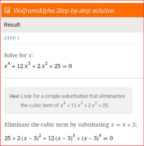

Wolfram gave the solution and a hint: i want to understand the hands on approach steps...
In my approach (following Wolfram's equation) i have,
##(x-3)^2(2+12(x-3)+(x-3)^2=-25##
##(x-3)^2((x+3)^2-33)=-25##
##(x-3)\sqrt{((x+3)^2-33)}=-5i##

You seem to have typo’s in the Title and the Homework Statement: presumably ##2x^3## should be ##2x^2##.
I’m not sure what you are asking. By using the substitution u=x-3 ##u=x+3## you can convert the equation into a ‘depressed quartic’ from form (##u^4+au^2+bu+c=0##; note there is no ##u^3## term). I guess that’s the gist of what Wolfram is suggesting. You then solve the depressed cubic quartic.
The technique is described in the Wiki article on quartics here: https://en.wikipedia.org/wiki/Quartic_equation
That's my guess.
Edits: as indicated by the strike-throughs!

The problem that you gave to Wolfram Alpha Is to solve the equation:
##\displaystyle \quad x^4+12x^3+2x^2+25=0##
Added in Edit: (Just about the same time Steve posted the following Post.)
The hint you, @chwala , were given could be more clearly stated as: Let ##\displaystyle\ u=x+3## . i.e. ##\displaystyle \ x=u-3## .
Look at the binomial expansions of ##\displaystyle \ (u-3)^4\ ## and ##\displaystyle \ 12(u-3)^3\ ##.
SammyS said:
So, Steve is correct. You have a typo.
Thanks. In fact I'd messed-up so would like to add this...
I don't like the Wolfram instructions/notation to substitute '##x=x+3##' which seems ambiguous/confusing.
I think Wolfram is saying: use ##u=x+3##, i.e. ##x=u-3##, so that the original equation:
##x^4 +12x^3 + 2x^2 + 25 = 0##
becomes:
##(u-3)^4 +12(u-3)^3 + 2(u-3)^2 + 25 = 0##
which, when expanded, gives the more manageable depressed quartic form.

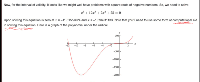

The textbook page below prompted me to seek for a method that would solve the quartic equation. Cheers guys.

I disagree with your source. You do not need to use any form of computational aid. There are ways to exactly solve quartic equations. Ferrari's method, for example, always works.
However, solving a general quartic by hand can be a real mess. (I admit that I've never actually managed to get the correct answer using Ferrari's method, except for the example problem I saw that was fiddled with to make everything easy.) I agree that you would probably find a computational aid to be quite useful, especially if all you need are approximate solutions.

As the graph shows
[tex]y=x^4+12x^3+2x^2+25[/tex]
[tex]y(0)=25 > 0[/tex]
[tex]y'(0)=y"(0)=0[/tex]
x=0 is an inflection point. Usually x^4 and smaller order formula show double well shape but this one has only one well. We know the equation has two real solutions of minus sign.
[tex]y(-1)=16 >0[/tex]
[tex]y(-2)=16-96+8+25=-47<0[/tex]
We know a solution lies in (-2,-1).
[tex]y(-12)=2*144+25=313 >0[/tex] which comes back to small plus.
We may suspect that another one lies in (-12,-11).
