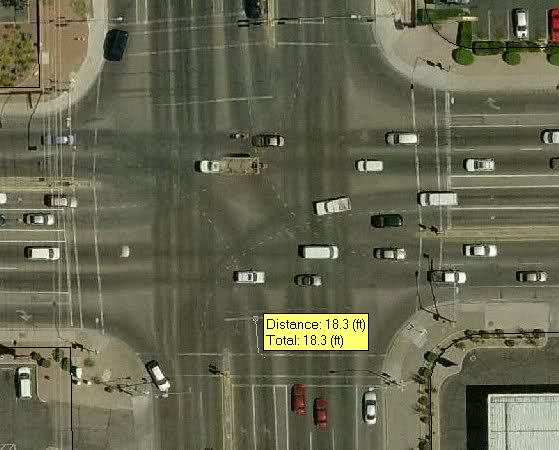

Most of the citations in Tucson go to people turning left with the green arrow. As a matter of fact only intersections with two left turn lanes have cameras. Most people get caught up by .2, 2/10th of a second.
The legal point of entry into an intersection is a line dawn from opposite curbs on the same side of the intersection. Cameras are only located at intersections with odd ball entry points. No two have the same distance out from the crosswalk to that line.
Try making a quick stop in front of the crosswalk when the yellow comes on and you will ultimately be rear ended (been proven). Stopping on the crosswalk is not legal.
Once on the crosswalk no light can be seen except the one off to the right and on the opposite side of the intersection which may be up to 150 ft. away. A driver is expected to look off to the right while turning left and stay in the correct lane all at the same time.

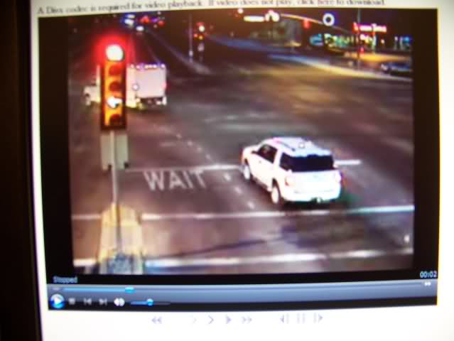

The picture above is a screen capture of an actual citation video. The DivX player allows a freeze frame. This picture resulted in my daughter in laws citation being dismissed by the judge.
The word WAIT has been removed because it was not standard traffic signage. It also confused the bejeezes out of people.
No red light comes on, all red lights are already on, the yellow simply goes out.
There is no safety factor at the end of the left turn with the green arrow cycle the lights stay red in all four directions for traffic to clear the intersection.

Prior to the installation of the cameras if a vehicle was on the crosswalk and the yellow arrow was still on the driver could legally proceed with the turn. The City admitted they made a mistake by requiring the public to educate themselves on the new law.
Oddly enough if a person is making a left turn or going straight through a non camera intersection where a policeman is present the old law still is in effect.
Correction the third picture is not a screen capture. The screen capture function would not work. I had to take a picture of the screen with my camera.
By law the yellow light must be on at least three seconds. It was later determined that the private company which operates the cameras had cut the length of the yellow by 1/2 second.
It appears to me that she would have had time to stop in 2.5 seconds since she is just beginning to enter the intersection and the light is already red. It appears she didn't try to stop when she saw the yellow light.
It takes a driver 1 full second to make the whoa or go decision, that leaves just one and one half seconds.
Look again. As I mentioned all lights are already red during the entire left turn with the green arrow cycle. The yellow arrow is still on in the picture with the front of the vehicle on the line.

Evo said:
... she is just beginning to enter the intersection and the light is already red.
In that image, the left turn arrow is yellow. There is no red left turn arrow, only the red light that is above the yellow left turn arrow.
