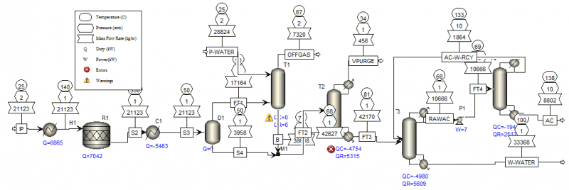

This is my converged aspen simulation of a process to produce acetone (AC) from isopropyl alcohol (IP). I used a heat exchanger simulation software and here are my streams

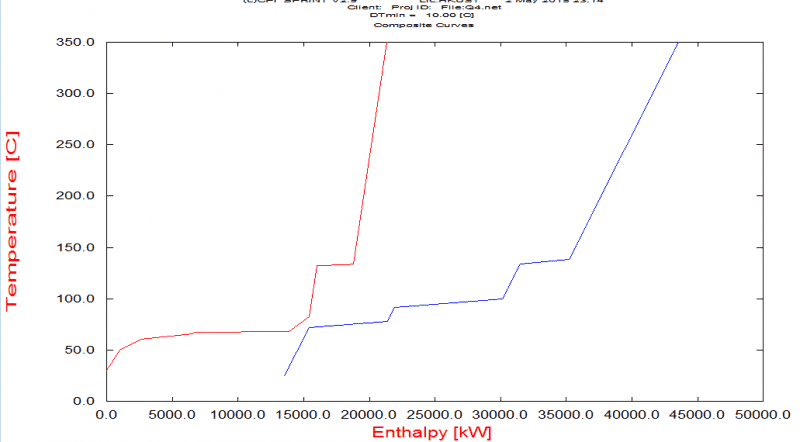

This is my composite curve

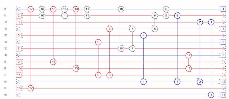

This is my heat exchanger network
I'm wondering what I could do to improve the efficiency of this process? Or at least places I could start looking and what I should look for.
Some new idea, I decided to add a heater before the reactor in order to preheat the IP, since I can use low pressure steam which is cheaper than hot oil for the reactor. However, for some reason the Aspen file will not converge when I add this heater. The amount of IP being fed is changed, even though I specify the amount. In the OP the mass flow rate is 19483 kg/hr, now its 21123 kg/hr. It is quite strange.

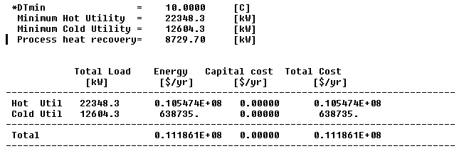

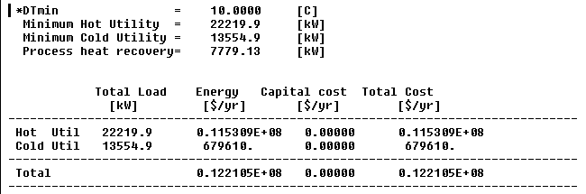

The Energy report from SPRINT
This is my original energy report from the previous iteration
Wouldn't trust any answer at all from a non-converged A+ simulation.
I have preciously little to go by, but my advice is to check the pressure drop in the feed preheater. T1 has trouble now (offgas flow disproportional) and then T2 crashes.
Good luck !
If you wish, I can send you the Aspen file, but in the mean time I will try your suggestion
Either that or increase the feed pressure.
Something else that came to mind: does the reactor do the same thing with a feed of 25 degrees as it does with a feed of 140 degrees ?
As far as I know there is no difference
If there are no temperature dependencies in the reactor, then it must be the pressure ...
Ah yes, I forgot that the pressure in the preheater should be 2 atm.

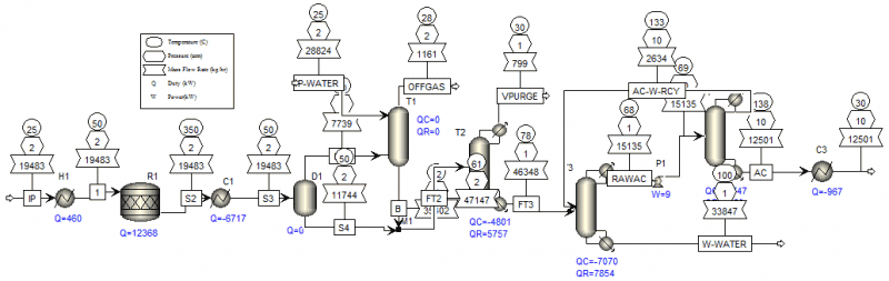

Okay, so I added a preheater before the reactor to IP, and a cooler for the AC.

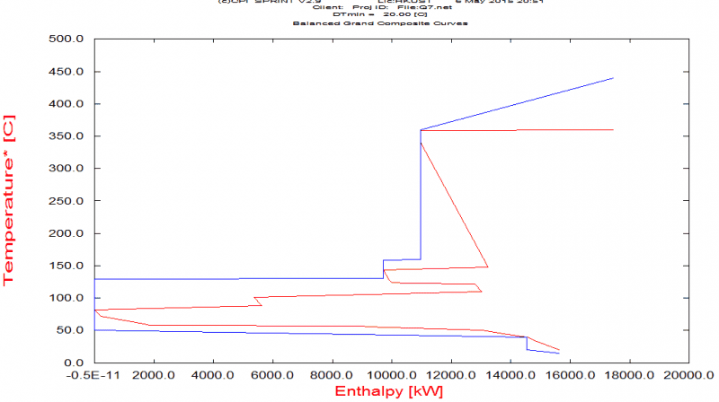

This is my grand composite curve, and I should somehow use it to improve my energy efficiency. I know the flat blue lines are the utilities that I need, but I am unsure how to translate this curve into my process so that I know where I should put heaters/coolers.

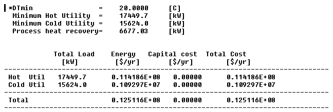

And here is my utilities cost (this one is higher because DTmin is 20 C), but I have improved it with what I have done so far
