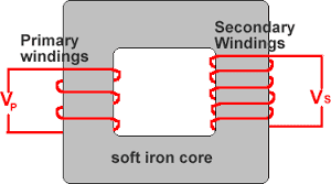

adeborts said:
) Where is this magnetic laminated core placed?
Sounds like you are talking about a transformer. The windings are wound on the core.
