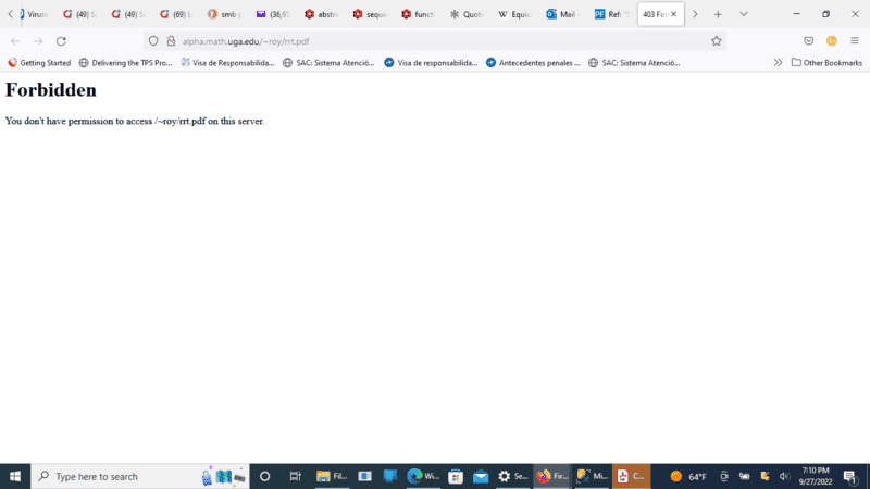

OK look at page 50 of these notes:
http://alpha.math.uga.edu/%7Eroy/rrt.pdfThe point is to use Whitney's formula for the chern class of a direct sum. Then we have that the direct sum of the tangent bundle of a hypersurface with its normal (line) bundle (which is known), equals the tangent bundle of the ambient projective space, which is also known. So by the 3 term principle, we have an equation involving 3 terms of which we know 2 of them. So we can solve for the chern class of a hypersurface in terms of the chern classes of projective space and of the normal bundle to a hypersurface. These "known" guys have chern classes expressible in terms of the class h dual to a hyperplane, namely that of P^r is (1+h)^r, and that of the normal bundle to a hypersurface of degree n is (1+nh).

Thanks, I have been meaning , hoping to go over that book for a long time now.
  • #43
@WWGD: I added an explicit link now, in post #41, that (may) take a lot less time than reading the book, or not. The point is if you know the (total) chern classes of projective space, then you can compute the chern classes of hypersurfaces in projective space too.
