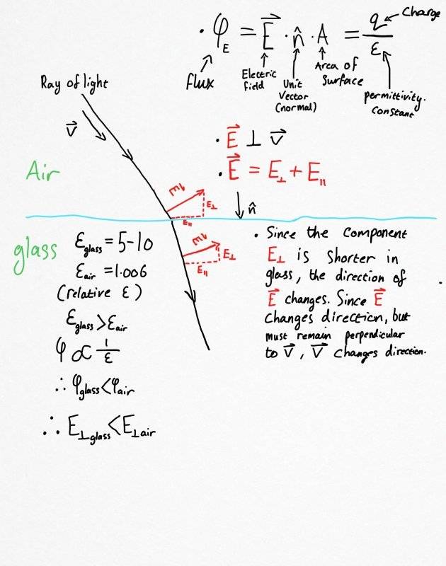

In my latest 10th grade physics lesson, we were learning about the refraction of light. I decided to share what I knew about why light slows down in a vacuum, which is, in short, because the electric field of the electromagnetic wave exerts a force on the charged electrons of a medium, which in turn causes the electrons to oscillate and create their own electric field wave, creating a new slower net superimposed wave.
As for the bending of light, it is due to the increased permittivity constant of the medium, which affects the components of the electric field and changes its direction.
However, at school, the teacher said that my first explanation was rubbish and that light slows down because the medium is denser and light 'has a harder time moving'. For the bending of light, he depicted it as an object moving from sand to mud, which slows it down on one end of the object, which changes the direction of the light.
From what I have heard, these are erroneous descriptions of refraction, but it is what we are taught. Are these temporary descriptions of refraction, or is it what we're going to stick to forever ?

Jaffer2020 said:
As for the bending of light, I tried to explain it in the image below (I hope it's clear enough to read). This is, from what I've learnt, out of the school curriculum , the classical approach to refraction, although there are other explanations (e.g QFT, principle of least action etc.).
I applaud greatly your attempt to understand behavior of the E field at the surface, but your attempt is incorrect in ways that you will learn...frankly more than I can cover here. Really the subject of college level course (as Griffiths book)
Perhaps the most telling indication is that refraction happens for any kind of wave (sound, ocean, or electromagnetic; tranverse or longitudinal) at a plane interface where the speed changes. So worrying about the E field is not the easiest path to understanding, because light is quite complicated.
A simpler correct explanation for refraction of waves comes from either Huygens construction or (from a different perspective) Fermat's principle as discussed by other learned folks here and yourself.

I applaud greatly your attempt to understand behaviour of the E field at the surface, but your attempt is incorrect in ways that you will learn...frankly more than I can cover here. Really the subject of college level course (as Griffiths book)
Are you able to briefly explain where I went wrong? So that I can keep a note of it. I started to read Griffith's "Introduction to Electrodynamics" book and Daniel Fleisch's "Student's Guide to Maxwell's Equations" and have so far only read up to Gauss's Laws:
∇⋅E = ρ/ε (For Electric Fields)
∇⋅B = 0 (For Magnetic Fields)
I am really interested in the topic and would like to learn it in depth (I am comfortable with Calculus and Linear Algebra), so I enjoy perfecting the details, to ensure I don't make mistakes.
Well, to start with, light is inherently an electrodynamic (i. e. not electrostatic) phenomenon so you need the full power of Maxwell's equations (which are extensions of Gauss and Faraday) and their extension into linear media. The constants you used also are frequency dependent (you used the static values). Then you need to understand fundamentally how the wave equation is contained in the Maxwell Equations for free space. Once you know this you will know a lot! It will take some time and cogitation. Work the problems. Learn deeply.
