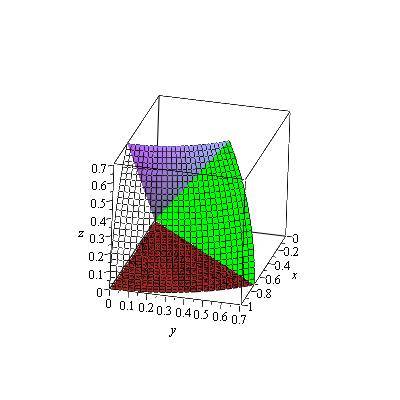

(2ii)
For this one, I'm having trouble describing the region. It's a sphere with radius ≤ 1, and based on the cuts given, it appears to be some kind spherical wedge, or even a slice of pizza pie, if the bounds for z is not too big. Is that correct?

Thanks for the responses, in regards to the second part, it's pretty difficult to visualise it. I did not realize there was a conic section until you mentioned it, but now I see the z^2 = x^2 + y^2.
How would one determine the angle for the rise? In other words, not the theta angle between y and x, but the phi angle, or the elevation? I'm thinking if the radius is a maximum of 1, then the phi angle would be Pi/4, the same as the theta angle since the point is (1,1,1). But I'm nto sure.

my description of the region for the second part was completely wrong. Sorry. Refer to LCKurtz diagram.
EDIT: It's actually the portion of the solid sphere [itex]x^{2}+y^{2}+z^{2}≤1[/itex] between the xz-plane and the plane y=x in the first octant, also hollowed out by the cone [itex]z=\sqrt{x^{2}+y^{2}}[/itex]. Does that make any sense, lol?
EDIT2: I included a diagram of the projections of the solid region onto each of the coordinate planes, though all the projections look the same so it's not very helpful.
Anyways, another way to find the lower limit of [itex]∅[/itex], though your reasoning seems perfectly valid, is to plug the equation of the cone into the equation of the surface of the sphere, simplify, switch to spherical coordinates, and solve for [itex]∅[/itex]:
[itex]x^{2}+y^{2}+(\sqrt{x^{2}+y^{2}})^{2}=1[/itex]
[itex]2(x^{2}+y^{2})=1[/itex]
[itex]2((ρsin∅cosθ)^{2}+(ρsin∅sinθ)^{2})=1[/itex]
[itex]2ρ^{2}sin^{2}∅(cos^{2}θ+sin^{2}θ)=1[/itex]
[itex]2ρ^{2}sin^{2}∅=1[/itex]
[itex]∅=sin^{-1}(\sqrt{\frac{1}{2ρ^{2}}})[/itex]
The radius of the sphere is [itex]ρ=1[/itex] so...
[itex]∅=\frac{π}{4}[/itex]
It's kind of intuitive though.
Also It is easy to see from the projections I included, namely the xz- and yz-plane projections, that the upper limit is [itex]\frac{π}{2}[/itex].
