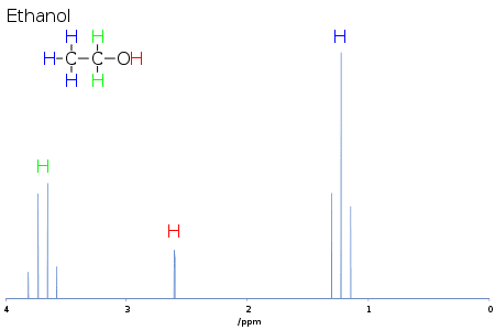

Consider the ##_{}^{1}\textrm{H}##-NMR spectrum of ethanol, ##\mathrm{{CH_{3}CH_{2}OH}}## in dilute, isotropic solution as illustrated below. Spectral assignments are given within the illustrated spectrum.
Two features are immediately obvious. First, the ##\mathrm{CH_{2}}## protons appear as a quartet of transitions while the ##\mathrm{CH_{3}}## protons appear as a triplet of transitions. This is the result of spin-spin interactions as will be described in greater detail below. Second, the two kinds of protons appear to be shifted from one another, this is the so-called chemical shift chemical shift that results from the nuclear spin being “shielded” from the applied Zeeman field by the bonding electrons within the molecules. These shifts are of the order of parts per million (ppm) of the applied field and need not concern us for the current discussion.
The spin-spin couplings that give rise to the triplet and quartet transitions are an example of ##\mathit{j}##-coupling. For two nuclear spins, ##I_{i}## and ##I_{k}##, within the same diamagnetic molecule the coupling is given by the following Hamiltonian:
$$H=2\pi I_{i}\cdot J_{ik}\cdot I_{k}$$
where ##J_{ik}## is the ##\mathit{j}##-coupling tensor which under the specified experimental conditions of a dilute, isotropic solution reduces to a scalar coupling constant characterized both by magnitude and by sign. Under the experimental conditions specified, the sign of the coupling constant is not important.
In more complex experiments, such as anisotropic solutions (liquid crystals for example), or in solid state experiments, ##J_{ik}## no longer reduces to a scalar and a more in-depth analysis is necessary.
In the vast majority of cases, an NMR spectrum is taken in the presence of an homogeneous, static external magnetic field, ##\mathrm{B_{0}}##, that is applied, by convention, in the ##z##-direction. That Zeeman field serves to lift the degeneracies of the spin states allowing observation of a spectrum. I am not aware of a satisfactory treatment of the Zeeman effect upon spin systems that is not quantum mechanical.
I hope that the above is sufficient to address the question asked. By no means do I suggest that every specific application of magnetic resonance spectroscopy demands a full quantum mechanical analysis. I do suggest that such analyses benefit dramatically from those earlier researchers who did undertake such full quantum mechanical treatments to enable the more qualitative analyses.

The article you provided was interesting and I learned a few things so thank you. The nuclear magnetic interaction (j-coupling) is mediated by the exchange interactions of the bond electrons and this is absolutely a Quantum Mechanical Phenomenon. No one would argue that the fine structure of atoms can be otherwise successfully addressed.
This has nothing to do with the original question about Larmor precession of the nuclear magnetic moment however. My point to the OP was that in this circumstance, the classical description of nuclear magnetic resonance phenomena in a classical Magnetic Field worked out fine because the gyromagnetic ratio was essentially a fitted parameter and population averages are involved. I won't reiterate.
Your point is perhaps valid if a little overstated. For instance you did not use Quantum Electrodynamics to describe the magnetic field. Why would we teach such a common misconception?? Small hammers some times work out fine.
