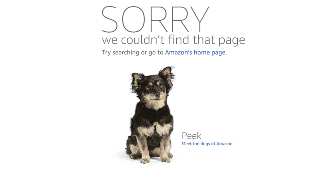

I don't know why in my computer your link is not working, I'm getting some error messages along with some dog
