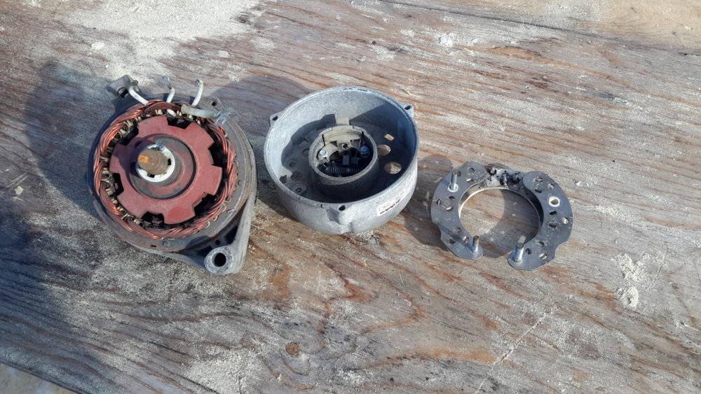

Tom.G said:
The photo of the burnt winding has what looks like a piece of metal sticking out at the fault location. This could well be the base cause of failure, perhaps a leftover from a previous rebuild. A rewind is due in any case.
at 300% several wires are burnt away
Kurtisinger said:
I am wondering if it was my setup that caused it or if it was already on its way out the door.
i don't think your hookup caused that. You would have heard arcing and smelt smoke.

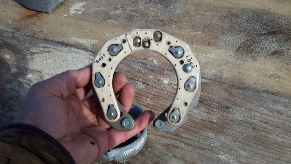

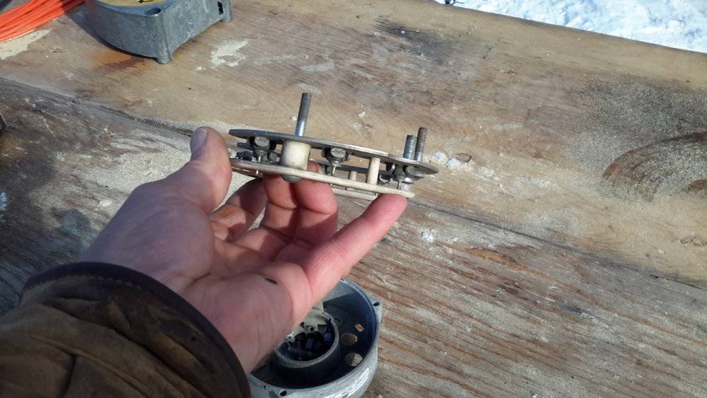

Kurtisinger said:
When I put this Weg 21 motor on it and started it up, it was producing 240 on all three legs at a little over idle, no 12 v boost required. I ran it for just long enough to get a reading, shut it down and checked the temp of the motor and caps, all were cool, then I fastened the Caps together and grounded them. It was the last time it produced more than 9v ac and that was with a 12v boost to the Caps otherwise it would only put out 3-4 volts.
I'd be interested how this critter was wired. What with the 24 uF/360V (oil-filled?) capacitors, mention of a "12 v boost", and motor belted to a gas engine it appears an attempt to re-purpose a 3 phase induction motor to perform as a generator. I don't have hands-on experience with these rigs, but from what I've read they're temperamental beasts.
Hi Asymptotic.. honestly, I don't have any experience with them either but as far as I can tell it's not much different than an three phase automotive alternator. Except of coarse, one is built for low voltage and high amperage and the other built for high voltage and low amperage. Both can be excited by DC to produce AC. So far I think the reason people find them to be temperamental is because they try to draw large amperage from them, trying to start motors etc. I am presently looking for large hp 3 phase motors because I see lots of industrial 3 phase equipment around for free or dirt cheap that I would like to have and use instead of investing in more expensive single phase equipment that have a shorter life cycle.
As far as those 360v 24 uf Caps go. I'm using them because I have more of them than other sizes. I was planning to put a bank of them on each leg to see if it would stabilize current draws. I have read many articles on how to size Caps and so far all that I've accomplished is further confusion as people say all kinds of stuff. Presently, I am incapable of doing the math to figure out exactly what they should be, plus my knowledge of AC is minimal as you already know. I am learning lots in this forum though, thanks to you guys... : )

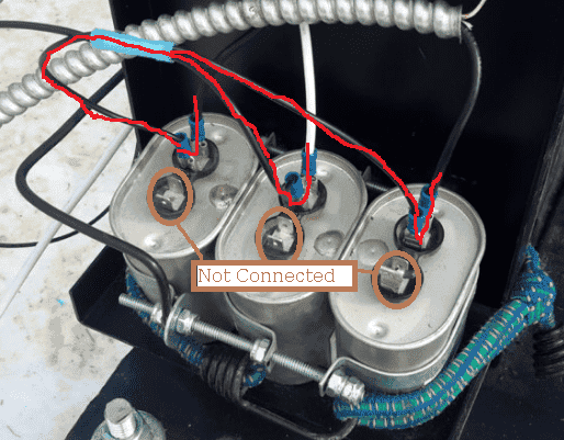

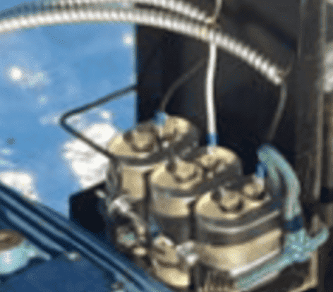

i too was curious
look up "Induction Generator"
it differs from an automotive alternator in that there's no external current going to the rotating part.
So it has to be 'excited' from the stator side
and that requires AC current to the stator in order to make a rotating magnetic field for the rotor conductors to 'cut' .
The usual implementation is to let it draw its magnetizing current from the grid.
though with enough external capacitance the motor can make its own exciting current
and at first that's what i thought @Kurtisinger was up to.
But i can't quite make out how he wired his capacitors.

What I meant is that they are both 3 phase.
Keep in mind that this is an experimental and very temporary setup. I do have a piece of welding cable and a spike for ground but the ground here is frozen solid right now.

dont worry about ground for now.
I see the capacitors effectively not connected on one side
but tied together on the other
so all they do is tie together those two black and one white wires that go someplace else.
With one side floating they're electrically "not there".If this is just a plaything
you might be able to figure out which of those burnt up wires goes with which
splice them by soldering into each a splice of similar sized copper wire between the loose ends
than soak the whole area with varnish or high temperature paint.
I've had good luck with woodworker's polyurethane varnish
and with engine enamel from the auto parts store.
It's cheap, takes an hour or two to prepare and solder the burnt wires
and works for me about half the time.
If there's insulation failed back inside the stator where you can't see it you'll have to rewind
but I've fixed appliance motors, a drill press motor and an automobile starter that way.
Good Luck
and have fun !
old jim

Sorry old Jim.. T1, T2 & T3 from the motor each go to a Cap. The other black wires go to a clip for the +12vdc to excite the windings. Some people say you need it and some people don't say anything about it. Interesting how the Weg 21 was putting out 240 without it. Especially considering the shape of it.
Yes it is a play/educational thing so I will try to patch it for fun, thank you.. So far all the photos of equipment that I have posted to this thread have come out of the junk pile and didn't cost me anything except for the belt and one pulley, about $30 worth. So if I blow something up it really doesn't matter. My main goal is education but I do try to use a little money every time I get some, to invest in tools as I have lots of space and I love to build stuff. Also one of my properties doesn't have grid service so it won't hurt my feelings to have brushless Gensets.
It's impossible this rig ever put out 240V as currently wired. Look more closely at the mark-up @jim hardy did in post #37.
These capacitors have (2) 1/4" push-on tabs on each capacitor connection pad. None of the wires are connected on one side of the cap, each of the motor 'T' leads are connected to the other side, and the black wires buttspliced together to the 'exciter' alligator clip lead are all connected to the motor 'T' leads on the same capacitor pads.
Trace it out.
Aren't the motor leads shorted together?
How should capacitors be connected to the 'generator' motor?
