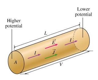

Your task is to calculate the resistance of a simple cylindrical resistor with wires connected to the ends, such as the carbon composition resistors that are used on electronic circuit boards. Imagine that the resistor is made by squirting material whose conductivity is [tex]\sigma[/tex] into a cylindrical mold with length L and cross-sectional area A. Assume that this material satisfies Ohm's law. (It should if the resistor is operated within its power dissipation limits.)
What is the resistance R of this resistor?
Express the resistance in terms of variables given in the introduction. Do not use V or I in your answer.
Diagram of a cylindrical resistor of length L and cross-section A, with current I flowing from the higher-potential end to the lower-potential end, electric field E and current density J drawn along the axis, and voltage V marked across the length.
J=[tex]\Sigma[/tex]E
V=EL
I=JA
R = V/I
I start out with Ohm's Law and get resistance R to be R = V/I and I know V = EL and I = JA so I get resistance R to be R = EL/JA. I also know J = [tex]\Sigma[/tex]E. So I get resistance R to be R = EL/[tex]\Sigma[/tex]EA
Would the two E's cancel out?
I will continue from your R = EL/JA expression.
J = [tex]\sigma[/tex]E
therefore,
R = EL/[tex]\sigma[/tex]EA
the E's cancel out and your answer should be R = L/[tex]\sigma[/tex]A
