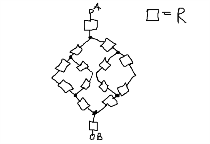

So each box in the picture has resistance R. Find the resistance between A and B.
R=R1+R2
1/R=1/R1+1/R2
I got the answer to be 3,5R. But as I am not sure if I approached the problem correctly, I would like to hear what you guys got for the answer.
Thanks in advance

To find the equivalent resistance, you see that there is some kind of symmetry. You can break the circuit as shown in the attachment.
Thats what I did, and got 3,5R. Wasnt sure it was correct. Thanks =)
Guess it would get more interesting if the resistances were different.
I get that too, taking advantage of the symmetry of the problem.
