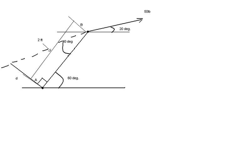

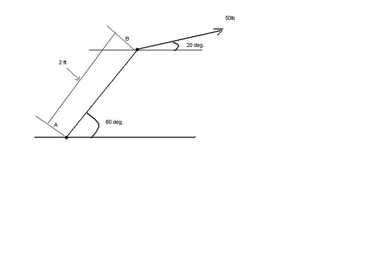

Determine the moment of the 50lb force about point A by resolving the force into horizontal and vertical components.
I am using the book statics and strength of materials 2nd edition by Cheng, and its problem 2-31, i have racked my brain and can't figure this problem out, or atleast get it to match the answer in the back of the book which is 64.3 lb*ft clockwise
My attempt at a solution, forgot that part, probably the most important part.
M(A)= Fd
tan40=d/2ft
d= tan40x2ft
d =1.68ft
M(A)=-50lbx1.68ft
M(A)= -84 lb*ft
M(A) = 84 lb*ft clockwise
Moment about a point (axis) is force times perpendicular distance from the line of action of the force to the point of rotation. This is uually the best way to calculate moments, but for simplicity, please break up the 50 pound force into its x and y components at B, then take the moment of each force about A and sum them , watching plus and minus signs. The perpendicular disance of those forces from A can be calculated from the basic geometry of a 30- 60-90 triangle.
You need to get the 50lb arm, at a 90 degree angle to the line AB...then take it times the moment arm...
The Moment of a Force is M= r x F
That would be |M|=r*F* sin(theta)
Thetha is the smalles angle between the moment arm and the force, and as you can see on the sketch made up by jvk2002 is 40 degrees. Therefore the magnitud |M|= 2 ft * 50 lb*sin(40).
Make this calculations and you will find that it is 64.3 lb-ft.

All these calculation are to complicated and doesn't get you to the answer.
You found the very easily the perpendicular vector of the force that is: 50 * sin(40) there was no reason to find the distance between the line of force and the point A.

There are a number of ways to calculate the moment, one of which is M=(r)(F) sin theta as noted above. This is what we are taught in Physics. However, the question specifically asks you to solve the moment by first breaking up the applied force into its x component (50cos20 = 47 to the right), and y component (50sin20 = 17.1 straight up), then calculate the moment of each of those component forces about A , which is force times perpendicular distance, i.e, using the properties of a 30-60-90 triangle,
M = 47(sq. root 3) - 17.1(1) = 64.3 clockwise, which of course is the same result. I assune you are taking an engineeering statics course and not PHY 101, and that is why the problem asks you to calcylate the momemts by first btreaking up the applied force into it s components, because generally speaking , this is going to be the simplest way to solve statics problems in most cases.
