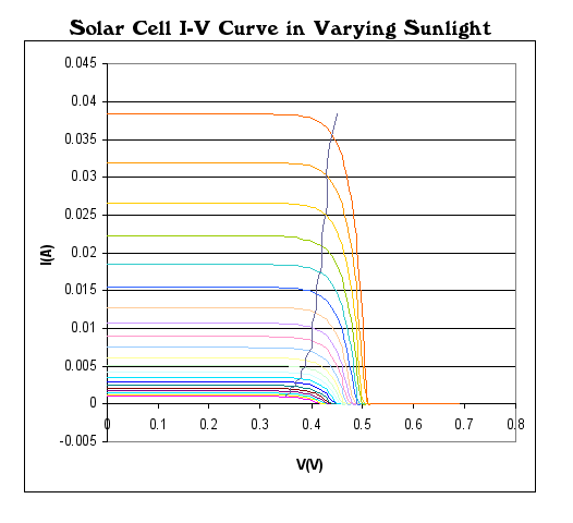

s-3a-2f-2fupload-wikimedia-org-2fwikipedia-2fcommons-2fd-2fd8-2fsolar-cell-iv-curve-with-mpp-png.png
Look at those curves. A panel (many cells) can look like constant current or constant voltage. The 6V nameplate is trying to characterize those curves with a single number.
I think your results are fine.

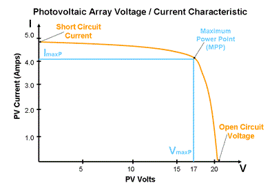

below is a typical characteristic curve for a 70 W solar panel If you draw a line on this diagram for V-=IR where R is the load, where the line and curve intersect will be the actual current and voltage for that resistance.. if you had a similar curve for your panel you could predict the current and voltage for your 10 ohms.
