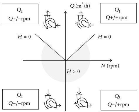

I thought that this question was quite well dealt with in your other threads where we discussed the interpretation of this diagram ?
I certainly don't want to be unhelpful but I am having some difficulty in understanding what the problem is .
A pump like the one shown in A.T.'s video has the four possible operating conditions shown in the diagram .

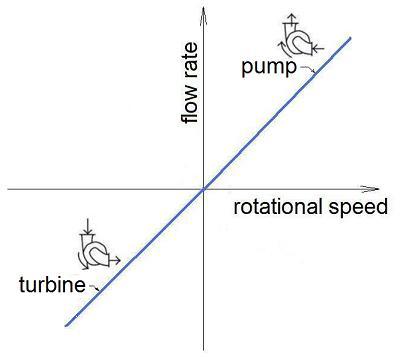

I suppose we could extend the plot of flow versus impeller speed to cover turbine operation.

Meanwhile let me use the oppertunity to ask question about Quadrant Up/Left of the diagram: Regarding to https://www.physicsforums.com/threads/four-quadrants-of-pumps.875380/#post-5500916 please explain both H<0 and H>0 in this quadrant. How these two conditions occurs?
If H represents the fluid pressure then I think H>0 means the flow is not freely leaving the discharge outlet. Rather it's impeded when it tries to leave the discharge outlet, for example if you are pumping fluid to an elevated tank.

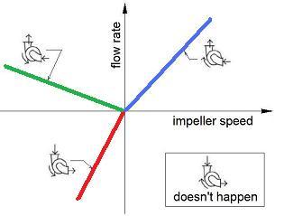

In the graph, the horizontal axis represents impeller rotational speed. The vertical axis is volume flow rate. When the pump operates normally, you obtain the greatest efficiency (blue line).
When the impeller rotates in the opposite direction, you get less efficiency (green line). You don't get as much flow even though the impeller spins fast. Hence the line slope is less.
When the pump operates as a turbine, fluid flow is reversed, and efficiency is again poor (red line). The impeller doesn't spin as fast even though you have lots of flow. So the line slope is steep.
