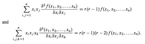

Suppose that f=f(x1,x2,...,xn) is a homogeneous function of degree r with mixed partial derivative of all orders. Show that
Two typeset equations: sum over i,j from 1 to n of x_i x_j times the second partial of f(x1,...,xn) with respect to x_i and x_j equals r(r-1) f(x1,...,xn); and below, the word 'and', then sum over i,j,k from 1 to n of x_i x_j x_k times the third partial of f with respect to x_i, x_j, x_k equals r(r-1)(r-2) f(x1,...,xn).
Can this be generalized?
We say that a function f is homogeneous of degree r if there exists r such that f(tx1,tx2,...,txn) = tr * f(x1,x2,...,xn)
I'm pretty lost on how to show these two. I understand that this is kind of like taking the "second derivative" of f with respect to t, but how do I introduce the t into the sum terms?
Just start from this equation and derive both sides with respect to t, then set t = 1. The generalization to all derivatives is obvious to you, isn't it?
