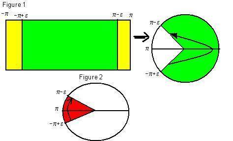

If the integral is [tex]\int^{\pi-\epsilon}_{-\pi+\epsilon}d\theta[/tex].
where [tex]\theta[/tex] is a angular coordinate.
In the riemman integral , i don't understand if tetha follows the path grenn in figure 1, or [tex]\theta[/tex] follows the path red in figure 2.

The green path. The angle increases from [itex]-\pi+ \epsilon[/itex] to [itex]\pi- \epsilon[/itex] counterclockwise.
