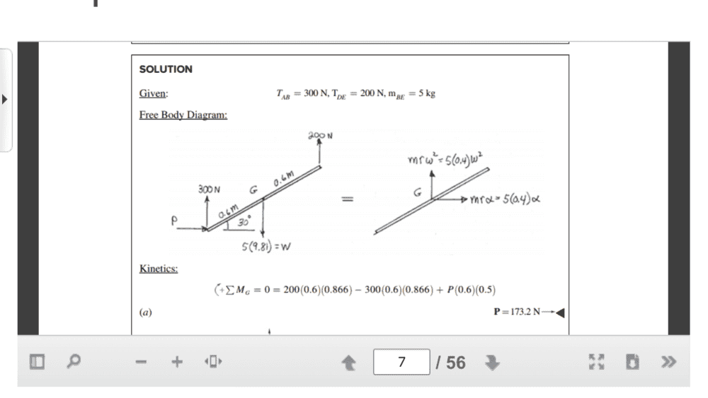

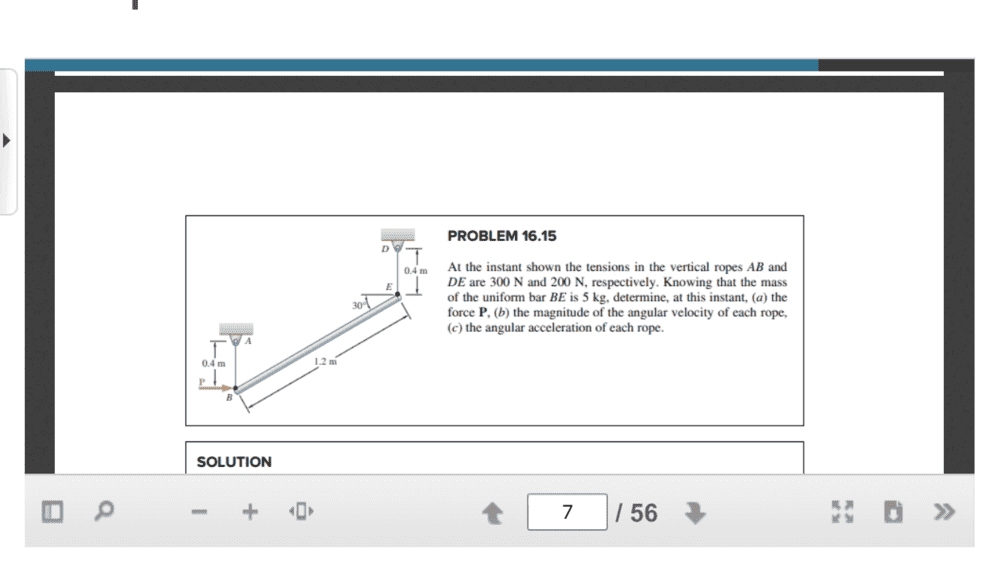

Problem and solution below
F = ma
Moment equation
For this problem I know how to get the answers but I have a few things I’m not 100% sure about. First how do we know that the rod is experiencing centripetal motion? Second, when using moment about point G how do we know that the angular acceleration is equal to zero? And third the radius is 0.4 because the two ends of the rod are in motion with radius of 0.4 right?
1. Because 200 N + 300 N > mg
2. Because the ropes fix the angle of the rod ##\rightarrow## it can't rotate around G
3. Yes

I see. Was my reply in #2 ok with you ?
Yea I guess I see it. Since the bar isn’t rotating around point G or around any point on the bar itself so regardless of which point I chose the angular acceleration will always be zero right?
