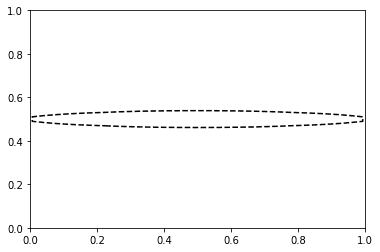

On a related note, consider the 2D Gaussian function below, for which a level curve has been sketched. Clearly it has a width and a length, and are either of these related to the variances? In 1D, the width is another name for the variance. In 2D, however, which is which? In this particular case I'm looking for the semi-minor axes of the ellipse.

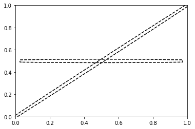

I don't know why, but somehow I don't get the Gaussian properly rotated. Consider the following code:
Python:
import numpy as np
import matplotlib.pyplot as plt
a=1.25
b=0
c=10000
d=(a-b+c)/2
e=a-c
f=(a+b+c)/2
fig, ax = plt.subplots()
x,y=np.meshgrid(np.linspace(0,1,50),np.linspace(0,1,50))
z=3*np.exp(-a*(-0.5 + x)**2-b*(-0.5 + x)*(-0.5 + y)-c*(-0.5 + y)**2)
w=3*np.exp(-d*(-0.5 + x)**2-e*(-0.5 + x)*(-0.5 + y)-f*(-0.5 + y)**2) #rotated by 45 degrees
cs=ax.contour(x,y,z,levels=[0.8],colors='k',linestyles='dashed');
cs=ax.contour(x,y,w,levels=[0.8],colors='k',linestyles='dashed');
print(d,e,f)
Then I get 5000.625, -9998.75 , 5000.625, and the following plot:

Concerning my previous posts, I think the level curves are correct, it is just when one rotates the Gaussian, its central axis changes to be the diagonal of the square, and so more of the function fits into the square and the level curve changes correspondingly, right? However, the integral is still not correct, since the domain of integration for the rotated function should be the rotated square. What are the integration limits for that rotated square?

So you're parameter transform looks good. Hmmm...
your c=10000 is huge that's a standard deviation of like 141.4 and you're "playing" in the unit square. Possibly both ellipses are off the grid but the pre-rotated one looks different due to truncation. Try c=1.
To integrate the rotated square you would normally just change coordinates, (effectively rotate back and integrate the original.) Or you can integrate over a suitable large standard square. You want the boundaries to be on the order of 10 standard deviations out from the mean. (I use 10 as a rule of thumb; it's easy to simply shift the decimal, but 6 should be sufficient.)
