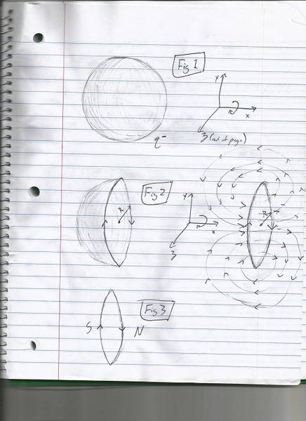

An electron as shown by the Stern Gerlach experiment behaves like a dipole (albeit only in one of two states). I have been trying to figure out how this is so and drew up the following sketches. A few assumptions were made about electrons such as 'distribution' of charge assuming static equilibrium resulting in a shell of charge. Charge distribution could also be spread out evenly or by some gradient from the center however the general result would still be the same.
Figure one shows the F.o.R. with our shell rotating about the x-axis in a clockwise direction when viewed from the positive x towards the negative. This rotation is the same for all three figures. Figure 2 is a cutaway about the y/z plane and a slice to it's right with direction of rotation shown again. So essentially the rotation of our charge distribution of some radius will act like a dipole just like a current loop with this case having a north pole facing the positive x direction and the south the negative x for all 'slices'.
The issue here is that an electrons dipole could point in any direction depending on its rotation and the magnitude of the Bf of each dipole would similarly be dependent on the speed of that rotation for whatever F.o.R. is used. As I understand it the Stern Gerlach experiments show otherwise as the electron can have only on of two possible directions of the dipole and of equal magnitude. Is this correct?

It looks like you are describing the dipole moment of a charged rotating spherical shell (whose cross sections behave like circular current loops) using classical EM hence not the dipole moment of an electron so what is the point of this? I'm having trouble seeing what your overall question is. The dipole moment of an electron is a result of its spin - it isn't rotating in the classical sense such as in your drawings.
That is correct. I used a shell instead of an even distribution of charge because charge distributions in static equilibrium on a conductive solid sphere behave this way.
WannabeNewton said:
...hence not the dipole moment of an electron so what is the point of this? I'm having trouble seeing what your overall question is.
Use a classical mechanics/EM view point to 'build' an electron that makes sense and see if it has a dipole. No surprise it doesn't match what has been observed with the Stern Gerlach experiments but it is still good to play with. As I understand it QM didn't become common place until classical physics resulted in only dead ends. Why not follow the same path, it's interesting and will make my comprehension of classical EM stronger while giving a better appreciation for QM (I understand it gets really hairy).
As I understand it you are correct. The 'spin' is really represented by angular momentum but there is no actual rotation of a 'particle'.
You can find the dipole moment of a spinning charged spherical shell here:
http://physicspages.com/2013/04/11/magnetic-dipole-moment-of-spinning-spherical-shell/
But don't try to use this, or a spinning charged sphere, as a realistic model for an electron.

You're essentially describing a curiously-shaped solenoid, which can be solved to find a magnetic field according to electrostatics.
I don't personally see the link to QM, even in classical physics I don't know why an electron would be modeled as a spherical conductor. Spin is just one of those things that has no classical analogue.
I would happily be proven wrong, but I can't see a connection between this model and an electron of quantum physics.
The term rotating electron has no classical meaning in the sense you are thinking of as has been stated, and as you yourself have recognized. However for a rotating uniformly charged spherical shell of radius ##R##, calculating the magnetic dipole moment is a common textbook problem (e.g. Griffiths) and is quite easy to do. Reorienting the coordinate system so that the rotation axis coincides with the ##z##-axis, you can break up the shell into infinitesimal circular current loops each of which will have magnetic moment ##d\mathbf{m} = \mathbf{A}dI## with ##dI = (\sigma v)( R\sin\theta d\theta) = \sigma \omega R^{2}\sin\theta d\theta ## and ##\mathbf{A} = \pi(R\sin\theta)^{2}\hat{z}##. This gives ##\mathbf{m} = \pi R^{4} \omega \sigma \hat{z}\int _{0}^{\pi}\sin^{3}\theta d\theta = \frac{4}{3}\pi R^{4} \omega \sigma \hat{z}##.
The reason for why an electron has a magnetic dipole moment is given by QM; it is not something you would calculate using classical mechanics.

Sure, you are free to do whatever you wish with classical mechanics as long as you see the limitations, which you personally do, so I don't see a problem. Good luck and cheers, till next time!
