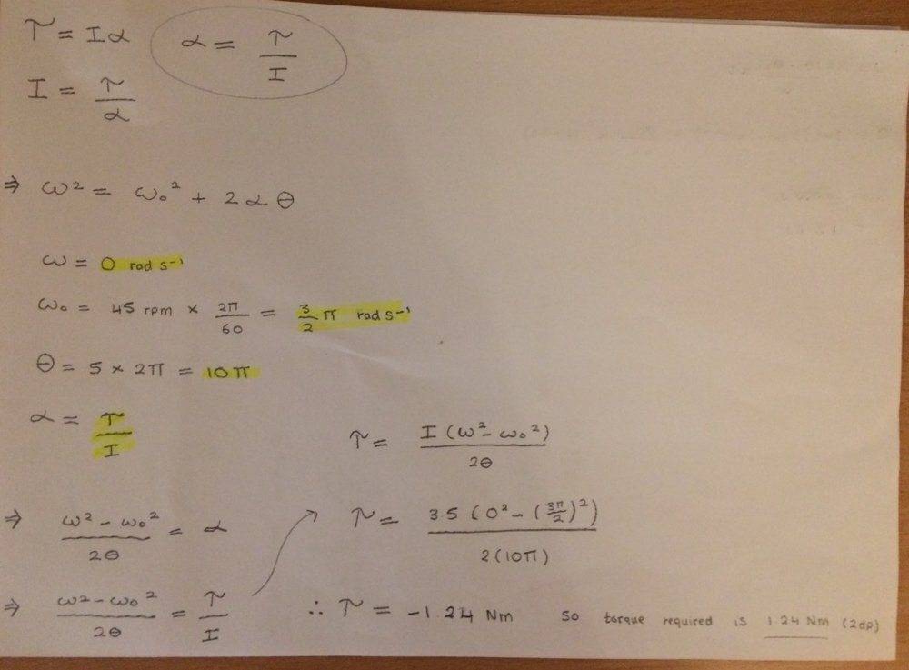

Working out torque from rotating flywheel
Rotational equivalent of SUVAT equations
Torque = moment of inertia * angular acceleration

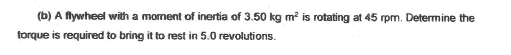

Hey everyone!
Was trying to answer this question and was wondering if this was the right way to go about it?
Any help would be really appreciated!
Sounds good.
Just remember to include units (I know it's a pain but as a "pseudo-physicist" I had to point it out.). Usually, including units throughout the entire problem is a good way to check if the solution is correct. If the units cancel out as desired, then your solution should be correct (unless you made some silly arithmetic mistake).
KDPhysics said:
Sounds good.
Ok thanks, I'll try to do that more often until it becomes second nature. It's not that I don't want to add units but always forget to :rolleyes:
Yeah... I feel you. You'll get used to it after a while.
