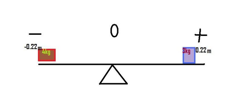

A 4.00 kg mass and a 3.00 kg mass are attached to opposite ends of a thin 44 cm long horizontal rod (see figure). The system is rotating at angular speed ω = 6 rad/s about a vertical axle at the center of the rod.
(a) Determine the kinetic energy K of the system.
(b) Determine the net force on each mass.
(c) Repeat parts (a) and (b) assuming that the axle passes through the CM of the system.
KE=1/2(0.3388m*N)(6rad/s)^2=6.10 J
F1=(4kg)(6rad/s)^2(0.22m)=31.7 N
F2=(3kg)(6rad/s)^2(0.22m)=23.8 N
CM=(4kg)(0.22m)+(3kg)(0.22m)/4kg+3kg=0.22m
How does the CM change the problem? I am having trouble figuring out the second set of answers.

What are you doing with the Center of mass equation? What lengths to the 2 masses do you get?
And aren't they supposed to add to .44 m?
Center of mass = [tex]\frac{\sum{(distance)(mass)}}{\sum{mass}}[/tex]
make sure to define your co-ordinate system
remember the CM is not changing, the rod is only at [tex]\frac{d}{2}[/tex] of the masses not at the center of mass
I just read your CM equation, you are using [tex]\frac{d}{2}[/tex] as your starting point, so wouldn't right be positive and left be negative?

What is the distance of each mass from the center of mass?
Can't you figure where the center of mass is and what those distances to each mass are?
Bones said:
I am confused.
Hey set your co-ordinates correctly, if your center point is 0, then to the right 0.22 m is positive to the left 0.22 is negative...---->THINK X AXIS <----- So you have [tex]\frac{(4)(-0.22)+(3)(+0.22)}{3+2}[/tex]
Your displacements are vectors, they have direction!
Its pretty straight forward
So the center of mass is -.03143m
Thanks!
Yes, or 0.0314 meters to the left.
More accurately CM is defined as [tex]\sum{\frac{m_{1}\vec{r_{1}}+m_{2}\vec{r_{2}}+...+m_{n}\vec{r_{n}}}{m_{1}+m_{2}+...+m_{n}}}[/tex]
It changes now because the axle is at the CM instead of [tex]\frac{d}{2}[/tex]
