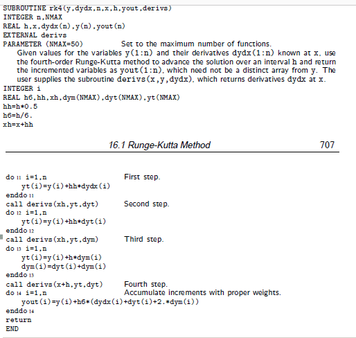

I have a problem to understand some parts of numerical recipe for runge-kutta. I can made it by myself but I am very curious how they do that:
Here are my questions:
1) Why "call derivs" is not in DO routine? What is only "yt"? I would expect "yt(i)".
2) How does subroutine "derivs" look like?? How can I make derivative of "yt"? It is one value. I don't know value in further points so how can I derive it?
Thank you for help.

Those little do loops are over the elements in the y vector (the dependent variables), they are not over the steps in the independent variable (x).
derivs computes all the derivatives in the vector in a single call so you do not need to loop over it. The derivatives of the different dependent variables might be different, so looping over them would not make sense.

Ok, so the loop is inside 'derivs'. Yes? And how 'derivs' find out what is dimension of yt? There is not a input for it.
Read the comment in the subroutine: "the user supplies the subroutine derivs". It is up to the user to figure out how derivs is to know the size of yt. (Note that since derivs is a specific implementation of a system of coupled ODEs, the size of yt is generally hard-coded.)

Ah...sorry I didn't know it is general term. I would google it. But I can write this formula to my code. And it works. Does it work same?

But look at the question. "yt" is single point and I have to produce derivative. There is my main problem.
You don't derive yt, you have a differential equation that tells you what the derivative looks like.
I think we need to take a step back. The point of a method like Runge-Kutta is to solve a set of coupled ordinary differential equations. The precise equations to be solved depend on the problem at hand. The point of the subroutine derivs is to implement these equations.

Ok. Could you be precise and apply it to practical example. Let's say: ##\frac{dy}{dx}=y'=f(x,y)## with initial value ##y(x0)=y0##. What is in calculation of first point next to ##x0## the ##dyt##?
In that case, the subroutine derivs is simply an implementation of ##f(x,y)##.
##\texttt{call derivs(xh,yt,dyt)}##
Set ##x = \texttt{xh}## and ##y = \texttt{yt}## and return ##\texttt{dyt} = f(x,y)##.

The easiest things are mostly the hardest one :-)
Thank you for all and patience.
