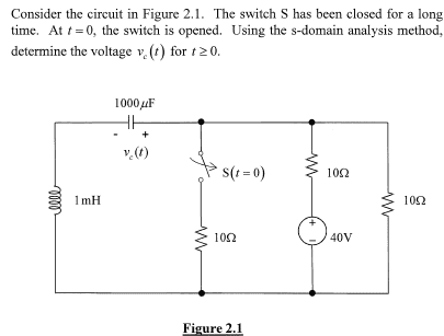

Circuit schematic for Figure 2.1: a 1 mH inductor and a 1000 µF capacitor with voltage v_c(t), a switch labelled S(t = 0), two 10 Ω resistors and a 40 V voltage source in a loop.

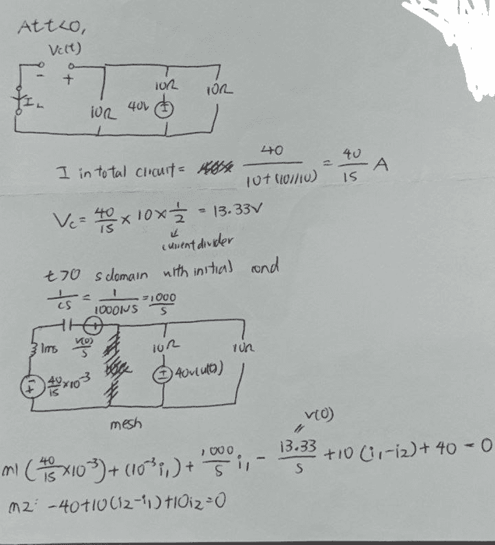

I've attempted this questions after understanding the theory from my lecture notes, but my equation is looking bizarre here. Is this correct so far?
Handwritten s-domain circuit analysis: at t<0 a circuit with Vc(t), 10 ohm resistors and a 40 V source; total current 40/(10+10||10) = 40/15 A; Vc = 40/15 x 10 x 1/2 = 13.33 V via current divider; then the t>0 s-domain circuit with 1000/s, 40/s and 13.33/s sources, and two mesh equations written below it.
Are my mesh equations correct here?
Thanks.

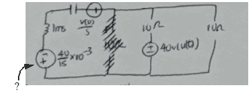

What's this voltage source all about?
Hand-drawn s-domain circuit schematic with a 1 mH inductor, a capacitor with source labelled v(0)/s, a 4/s x10^-3 voltage source, a 10 ohm resistor, a 40 V(u(t)) source and a 1 ohm resistor, with a question mark and arrow at the left.
At steady state (t = 0-) there's no current through the inductor, so it shouldn't require an "initial condition" source.
My first instinct would be to reduce the voltage source and resistors to their Thevenin equivalent before writing loop equations. That'd reduce your ##t > 0## circuit to a single loop (and hence a single equation):
Circuit schematic with a 1000 µF capacitor in series with a switch S(t = 0) feeding a 10 Ω resistor and 40 V source, parallel to a 1 mH inductor, with a 10 Ω resistor on the right; Vth and Rth terminals marked.
