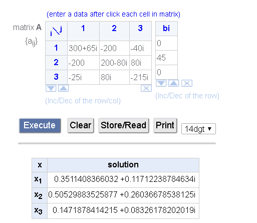

For mesh1, it should be -25jI3 instead of 400jI3

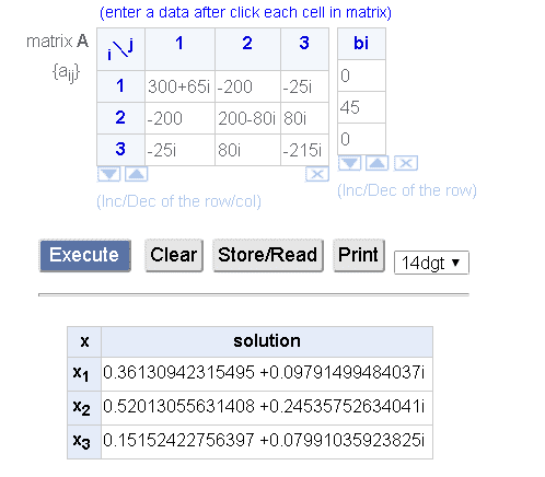

I used an online calculator and got this:
Your 1,3 entry of the matrix should be identical to the 3,1 entry.

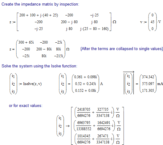

Here's a Mathcad version:
