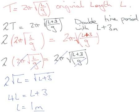

The time period of a simple pendulum is doubled when the length of the pendulum is increased by 3.0m. What is the original length of the pendulum?
T= 2∏√(l/g)
also l is original length and l+3 is the new length
So
2T=2(2∏√(l/g)
2T=2∏√(4l/g)
The new length is 4 times the original length and it also has to be the original length plus 3m.
∴ 4l=l+3
so l=1m
I am happy with the mathematical steps, and it gives me the correct answer.
It is the reason why I can do this I could do with some guidance on.
Is it because when I double T the only thing that could change is the length?
Therefore I can put the multiplying factor of 2 inside the sqrt as 4×l.

yes, that's exactly right …
T = 2π√(l/g) means that T is proportional to √l, so twice T means 4 times l (if everything else is the same) :smile:
(and your proof is completely correct)
What you did is fine. But you were lucky to have been able to sneak the "2" inside the square root sign so easily to make 4.
I would have said
T = 2π√(l/g)
2T = 2π√[(l+3)/g]
so 2 = √[(l+3)/l]
& solve for l.

So in general I can solve it like this.
Did the sqrt of 4 only work for those values.
I tried doing the calculation both ways for a pendulum that's time period has tripled when the original length is extended by 6m and got the same results.
Yeah, maybe I was a bit severe here ... did you try for new l = 1.73l? This is a very trivial point, should probably not even have raised it.
