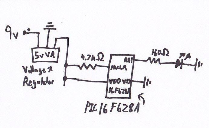

I'm working with an instructor at the local community college to fix a bug in my first project, but he asked me to give him a schematic to look over before we meet in person. I know what resistors and the other simple stuff looks like, but I don't know the symbol for ICs and VRs.
Since the symbol for ICs are dependent to each individual IC, do I just draw a box and label the pins I'm using? That seems the most intuitive, to me.
I have no idea what to do for the VR. Can someone upload a pic or something? It would be immensely appreciated.

Okay, that makes sense. I'm going to draw it on a piece of paper. I'll post a pic when I'm done.
Thanks again.
How's this? Can you read it?

I've been on the sending and receiving end of schematics, and there are a few basic rules that I find helpful (almost essential at my age). They are:
Ground symbols and negative power supplies point downwards
Positive power supply terminals point upwards
Incoming signals flow in from the left and have a destination note if leaving the page
Outgoing signals exit to the right and have a destination note if leaving the page
Simple devices, like regulators, are best presented simular to the actual pin orientations.
Pin numbers are essential
Complex devices or devices that tend to get lost in circuitry are better drawn with an extra "gate" that represents where they are connected to power pins. Which devices? logic gates, op amps, large chips.
Finally, Some devices require power supply "maintenance" close to the chip or module. This is typically in the form of capacitors, but may include ferrite beads, resistors, or inductors. Keep these items close to the associated component such that their function is more apparent.
Best Wishes,
Mike

whereever possible ALWAYS point GND (grounds) down
here's the standard for a 3 term regulator you put in the appropriate part # in the box :)

Okay, I messed up the ground symbols and the positive charge isn't pointing up, but other than that, do I effectively get my idea across. I'm okay with seeming novice; I am novice. :) I'm only worried about effectiveness. The rest will come with experience and education, should I decide to pursue a career or hobby in EE.
