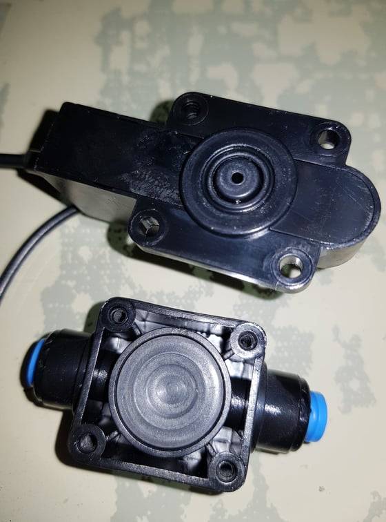

Ok. I was able to let the technician remove the high-pressure switch since the UV light can't be turned on 0.5 sec before turning on the faucet (thanks to Asymptotic and others for this). Here is the external and interior diagram.
After opening the screws. We saw it was a combined Tee (?) and pressure switch (as one of you rightly guessed). Using a continuity meter, the technician determined the wire was continuous at default. When the center (at top) was pressed, it became disconnected.

This is internal of the switch component in the above picture.

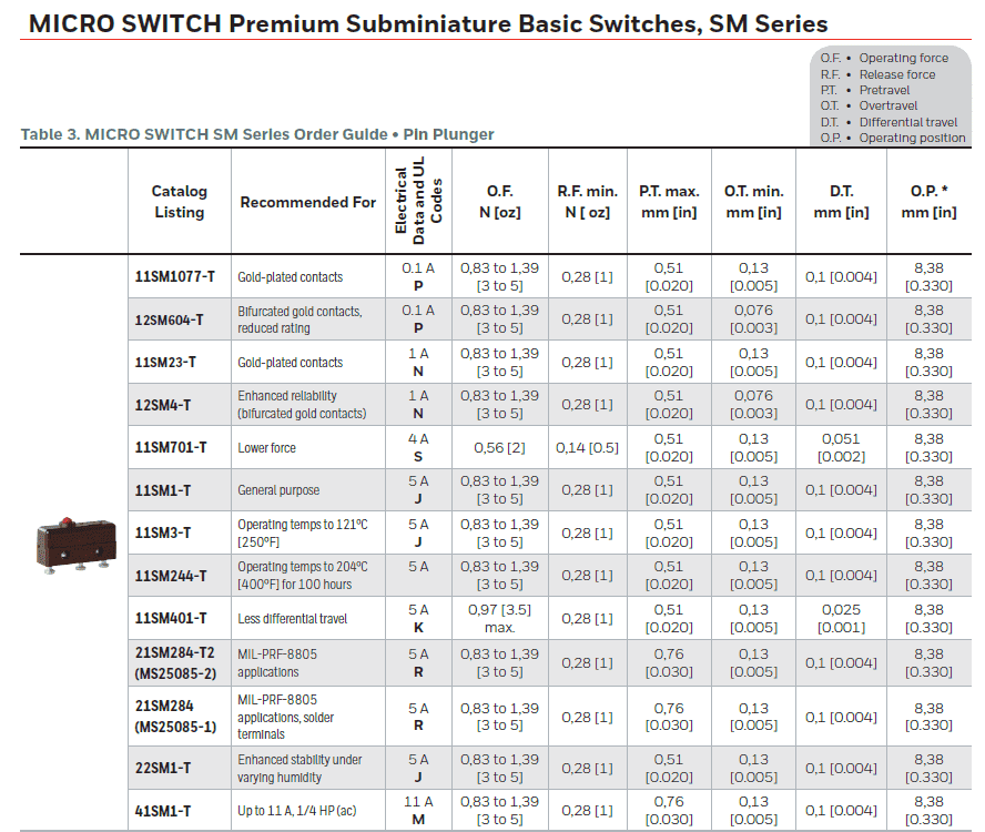

It has a switch inside, when you press it, the terminals get disconnected in continuity. It is like an on and off switch. Is this the same in ordinary high pressure switch (see below)? What controls the sensitivity is the spring. When you turn the hex allen key clockwise. It makes it harder to press the button. Can anyone identify what kind of switch is the above (rectangular thing that makes a clicking sound when you press it (which disconnects the terminals continuity)?
I'm asking this because early this week when I turned the hex key fully counterclockwise. It worked half a day but afterward it no longer worked, meaning there was not enough pressure to press the switch and turn the switch off. It was on the whole week (and I didn't bother to fix it again because I wanted the UV lamp to stay on after reading Asymtotic comments of UV lamp taking 3 minutes to be optimal).

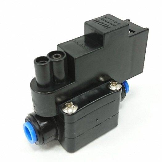

In ordinary high pressure switch, only the springs controls the sensitivity and there is no switch like a light switch?

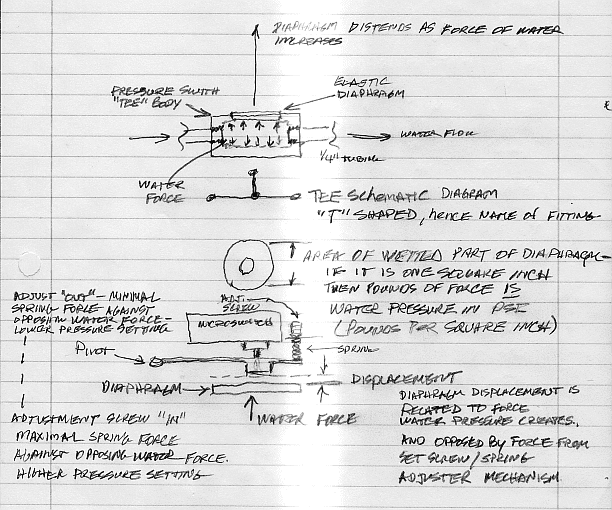

  • #44
Do you have in mind a micro-miniature version of a toggle switch like those often used to turn lighting on and off? No, probably not.
Electromechanical switches come in all shapes and sizes with a wide selection of actuation methods - everything from a small snap-action switch like this example to massive ones used to isolate power transformer - but all of them boil down to a device that connects two conductors together (switch closed) and separates them (switch open).
In your case, water pressure creates force on the 'wet' side of the diaphragm, making it distend by some distance (more pressure >> more force >> a longer travel distance). The 'dry' side of the diaphragm presses against a cylindrical piece molded into a lever arm, and that lever arm comes into contact with the movable element of the snap-action switch.
The hex screw/spring adjustment puts force on the switch side of the lever arm. It is in opposition to force transferred from the diaphragm (the force created by water pressure). More spring force >> more opposition to water pressure-created force >> higher pressure switching set point.
There are hundreds of varieties of snap-action switches, but most of them share common traits. Study this table outlining of one type of pin plunger actuated switch manufactured by Microswitch, and explore what they mean by operating and release force, pre-travel, over-travel, and differential travel.
From https://sensing.honeywell.com/switches/general-purpose-basic-switches/sm-series
Once the diaphragm extends enough to make the lever arm touch the snap-action switch plunger (if indeed it is plunger actuated) it has to do so with enough force to overcome the switch's operating force, and must extend beyond the 'pre-travel' distance before the switch contact opens (or closes, as the case may be). It's up to the manufacturer of the device using the switch to prevent actuation past the over-travel distance, beyond which damage will occur.
