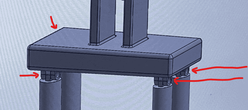

What is stronger and better for continuous movement? Screws or pins for a mechanical component made of titanium Ti-6Al-4V
Welcome to PF.
Do you mean bolts (or machine screws) versus pins? Can you be more specific in what the fastened joints look like?
This is a design concept for a fully titanium mechanical device that will be implanted in a patient. It needs to be determined in screws or pins could be placed where I highlighted in red. For purposes of being able to sustain patient daily motion, weight, torsion, I'd want to get some insight to see if overall it would be better to use screws instead of pins.
Still this is in the design concept phase, but just want to know do that I move forward in the best possible way.
As far as weight and torsion capabilities, a cylindrical pin and the unthreaded shank length of a bolt have the same geometry, so both would be acceptable in that respect. The reentrant edge of a screw or bolt with a flanged head would cause a stress concentration, so if that's a concern, you might choose to use some unflanged pin. As far as sustaining cycles from motion, vibration, etc., that depends on how you'd plan to secure the pin or bolt. Pins are more readily able to be permanently secured from what I've seen.
Thanks for the drawing. I'm pretty familiar with human A&P, but I'm having a hard time picturing where I would place that in a patient (Pt). Can you say more about the application? What are the expected stresses on those pinned joints? What is the range of motion for those joints? What is the mechanism of lubrication of those moving joints?
And what medical safety standards are you designing this to? 14971, 10993, 62304, and 13485?

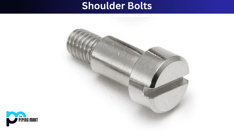

If you use a shoulder bolt, there is no real difference compared to a pin. The shoulder bolt is just a pin with its own locking mechanism. The real question is therefore: How will the pin be secured and how does this locking and positioning system compare with a screw and nut?
Except a pin cannot loosen once it is flanged, right? A bolt can loosen unless it uses a lock washer or similar add-on. Still, I'm not sure how this all applies to implanting this inside a Pt and the medical safety standards...
