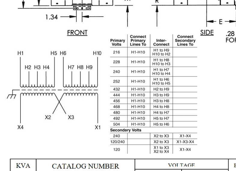

Can I use a multitap transformer to step up 120 to split phase 240? Transformer schematic attached
My plan is to power the secondary with my 120VAC generator and use the 240VAC primary connection configuration and use the H3 and H8 taps as the neutral.

Yes, but not in the normal application. You want to basically drive a 120V winding, and get a center tapped 240V output, which would be two 120V, out of phase, and connected at the output neutral, correct?
The problem is this transformer only has the X1-X2 and X3-X4 windings rated at 120V. The other windings are much larger in voltage. As below:
H1-H2 = H9-H10 = 216V
H1-H3 = H8-H10 = 228V
H1-H4 = H7-H10 = 246V
H1-H5 = H6-H10 = 252V
So you can make ~240V in the H windings, but you can't get a 120V center tap. What you are looking for is a winding ratio of 1:1:1.
It can be done if you connect the X windings in series, the 240V configuration. But you would only drive it at 120V. Then connect the H windings in a 480V CT (or 2x 240V) configuration. Since you are only driving the X windings at half voltage, you only get half of the voltage out of the H windings. So, if you use the H3 and H8 taps, as you suggest, you'll get 228V CT out. If you really want 240V CT out, I would connect it as suggested for 480V with the neutral at H4 and H7.
Of course you will have to derate the power (VA) rating by 2x to avoid melting the copper windings. You don't get to double the current because you cut the voltage in half.

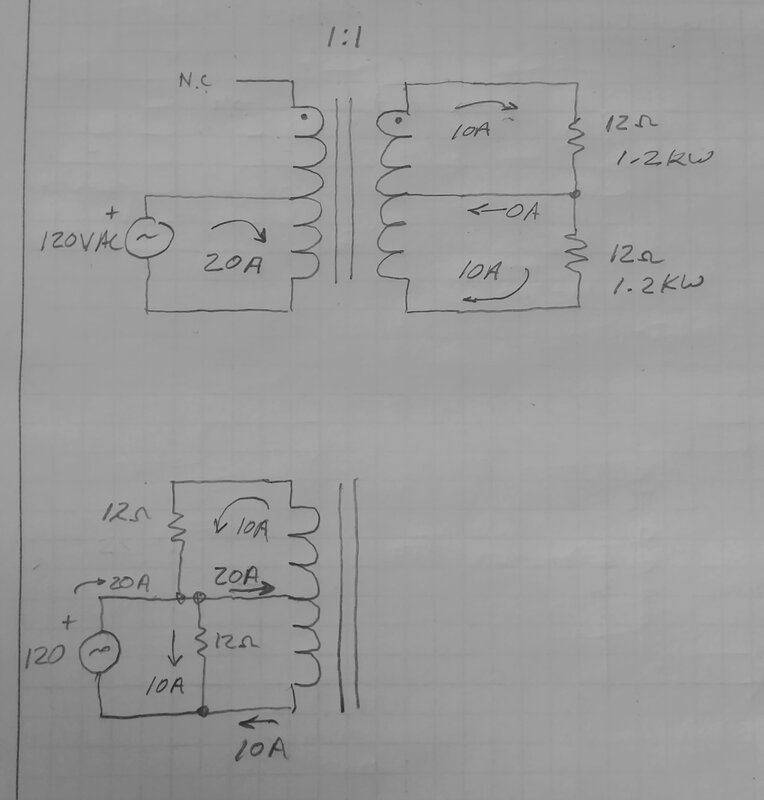

If you do not need the isolation between the generator and pump, there is an easier way:
Connect the transformer Primary for 240V (X2 to X3)
Connect the generator to one half of the primary (for instance to X4 and X2/X3)
Connect the pump to X1 and X4
You can get away with this because the transformer is way oversized (5 times) for the pump. (It would need a minimum of 3X oversized)
edit: If one power lead from the generator is low side ("Ground"), connect it to the X2/X3 terminals. That gives you the conventional 2-phase 120V/240V connection.

Whoa! I wouldn't have thought of that in a million years and I only kinda understand it now. If you've got a few minutes would you mind explaining how it works and how the derating factor is arrived at.

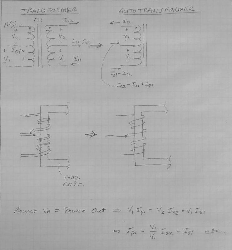

An autotransformer works just like a normal transformer, except that there isn't any isolation between the primary and secondary windings. This means that the primary and secondary currents are flowing in the same wires and will partially cancel.
I like to explain it as in the picture below: Imagine that when you wind a normal transformer you use a bifilar winging. That means that the primary and secondary windings are identical and are physically laid side by side. Because they are identical, the (instantaneous) voltage at any point along the primary winding is equal to the voltage on the secondary winding next to it. So, there is no need for insulation between the primary and secondary windings. No voltage across the insulation means no current flow. Of course, insulation is required between the adjacent turns of each winding; but let's say the windings are spaced apart (turn to turn) so air is the insulator.
If no insulation is necessary between primary and secondary, then we can remove it and have the wires touching along their entire path. But touching wires is practically the same as a single winding. Now the primary and secondary currents are flowing together in a single wire. The polarities mean that they cancel, at least partially. That is the genesis of the derating. Some of the current can then bypass the transformer "primary" winding and flow directly through the load.
For a hopefully simpler explanation, refer to the transformer wiring diagram in the first post.
In particular the Secondary Volts table connections of X1, X2, X3, X4.
Now remember that a transformer doesn't care which windings you use as a primary, secondary, tertiary, or whatever. The relative voltages are determined by the turns ratios between the windings.
1) For 120V on the secondary, the two windings are wired in parallel. This implies that the windings are identical; if they were NOT identical there would much current from one winding flowing thru the other one. Not very desirable.
2) Now for 240V, the windings connect in series; two identical 120V windings in series for 240V. If this is an output it would be considered 120/240V two-phase.
3) Since a transformer doesn't care where the power comes in or goes out, you can apply 120V INPUT from the X2/X3 connection (the center tap) to either end of the winding, X1 or X4.
4) The 'other secondary' (other half) winding is still connected in series with the winding where you supplied power.
5) Since they are in series (with the correct phasing), you get 240V across the winding ends (X1 to X4).
As @DaveE pointed out, this configuration is called an 'autotransformer', or rarely an 'autoformer'. There are commercial products used as test equipment that can supply a continuously variable voltage from zero to above line voltage. This is done with a sliding contact that can be positioned at each turn of the winding. Two common brands in the U.S. are 'Variac' and 'Staco'. Try an internet search for them for more info.
As for the derating, I chose 3 because I was (and am) too lazy to look it up/investigate in detail. It is based on the fact that the wire used for the powered part of the winding (and the Iron core) must support the total power withdrawn, plus losses. Perhaps the derating is closer to 2, but I chose to be conservative.

The increased power handling ability of autotransformers vs. isolation transformers is due to the elimination of the primary winding. The size of transformers is a combination of the core size required plus the amount of copper wire required. The core size is determined primarily by the applied voltage and frequency. Then the geometry of that core allows a limited amount of space for the windings. The power is determined by the voltage applied times the current capability. The current capability is determined by the I2R losses allowable in all of the windings.
In my previous example, the isolation transformer needs primary and secondary windings: 2 windings that can carry 10A each and one winding that can carry 20A. It would be common practice to split the Cu losses equally between the primary and secondary windings (equal power dissipation density). This means that the primary winding resistance will need to to be 1/2 of each secondary winding resistance (let's call that Rs). So the total resistive heat is 202⋅(Rs/2) + 2⋅(102⋅Rs) = 400⋅Rs. The unused primary winding would be left out to allow more copper in the other windings.
In the case of the autotransformer, the core can be the same (since the voltages on the windings are unchanged), but there isn't a primary winding any more. This will allow you to increase the diameter of the wire in the secondary windings to allow more current. Twice the wire area means half of the winding resistance. so, for the same resistive losses the secondary can now carry 20A ( 400⋅Rs = 2⋅202⋅(Rs/2) ).
The elimination of the need for a primary winding allows more space and thus more current in the secondary windings for the same amount of copper losses.
But, this applies to a design optimized as an autotransformer. Since you have a transformer that was intended to operate as a normal transformer, with isolation, you won't get this benefit. If you wire it as an autotransformer, it will work as originally rated, but some of the winding space will be filled up with windings that you aren't using. Transformers like this give extra windings to allow flexibility at the expense of optimization of efficiency. Your transformer is only working at peak efficiency when all of the windings have the maximum allowable current flowing through them. Otherwise, they should be derated to some extent.
It is common in autotransformers to see dramatically reduced wire diameters in some windings because the application doesn't require much current flow through them. This can't be done in general purpose transformer designs.
