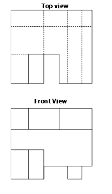

I'm having a hard time envisioning what the orthogonal view of this object in 3-D. It is mainly because of the continuous surface on the front view. Is that way in the back and the there are rectangular blocks sticking out? Thank you. I would have an easier time if a right view was included but there are the only two views.
Matriculator said:
Is that way in the back, and then there are rectangular blocks sticking out?
Yes, exactly. Very good, Matriculator. There are rectangular blocks sticking out.
It is complicated and tricky.

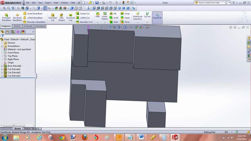

I didn't build this to scale is it something like this?
When I display the views in SW they seem to match up. But I still think that it's still be a bit too convoluted to be that.
Matriculator: Yes, you drew it correctly in post 3. Nice work.
Thank you very much sir. I spent hours thinking about this.
