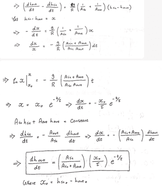

For Part (b) I can basically follow the other thread as we are at a point now that I can bring the equation to meet the equation here although I don't really see how they did the step shown by the red arrow
For part (a) could I integrate the left hand side between limits of h1-h2 and h1,0-h2,0 to give:
$$(h_1-h_2)-(h_{1,0}-h_{2,0}) = -{D\,g\over R_f} {A_1+A_2\over A_1 A_2} \,(h_1-h_2)t$$
$$-h_2 = -{D\,g\over R_f} {A_1+A_2\over A_1 A_2} \,(h_1-h_2)t+(h_{1,0}-h_{2,0})-h_1$$
Along the right lines here?
$$\Bigl .\ln x\,\Bigr |^x_{x_0} = \ln x -\ln x_0$$
I don't think so !
What left hand side ? The ##\displaystyle{dx\over x}\ ## integral was done and gave ## \ln x -\ln x_0## !
How about 'stealing' the answer from the other thread ? Or don't you like it :rolleyes: ?

Thanks for that explanation.
So their final answer of
is suitable for part (a)?
Is their method of identifying the time constant of 63.2% also suitable?
Jason-Li said:
So their final answer of ... is suitable for part (a)?
What do you think? Can you find fault?
I don't think I can see a mistake with the formula however going back to post #35 where you said to find h2, the attached image in #38 isn't expressly looking for h2 rather dh2/dt but this is likely still correct. Think I have a lot of doubts at the moment, apologies.
In terms of part b if my "time is over tau then the time constant should be 63.2% in line with first order systems
I see what you mean. But I suppose an extra integration is unavoidable. One way to look at it: ##h_2-h_1## (and thereby ##Q##) follows from solving the differential equation & initial conditions. Subsequently ##h_2## follows from ##\ \displaystyle{ \int {dQ\over dt}}##.
