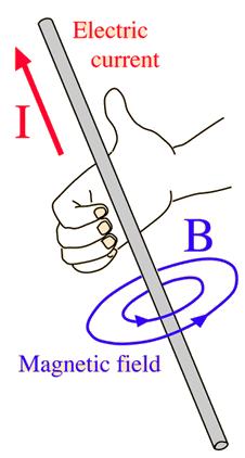

If I have 120 vac power cord and I wrap a coil around one of the conductors, will a current/voltage be produced in the coil? If so what are the equations that could be used to characterize this arrangement? I.e., how many coils, what size wire, etc. To produce a certain voltage in the coil?

In that case, the magnetic field from the current in the conductor will be at a right angle from what you need to induce a voltage in the pickup coil. Not going to work that way, sorry.
I'll try to find some good reading for you to learn about how transformer action works. Basically, the primary current needs to generate a magnetic flux, and that changing magnetic flux needs to be flowing through the area of a pickup coil. The magnetic flux generated by a current in a conductor flows around that conductor, so if you wind the pickup coils around the conductor, they are parallel to the magnetic field instead of orthogonal to it, and will not pick up any induced voltage...
If you cannot use a current transformer, your next choice is to use a Hall effect pickup for measuring the current (and its magnetic field). Have you looked into Hall effect sensors yet? :smile:
First figure shows the magnetic B-field generated by a current in a wire. Second figure shows how a changing B-field needs to pierce the area of a conducting loop to induce a changing voltage in that conductive loop...

Right-hand rule diagram: a hand grips a grey wire with the thumb pointing along the red arrow labelled I for electric current, and blue loops labelled B for the magnetic field curl around the wire.

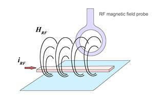

Is a metal core "ring" required to surround the conductor or can the secondary coil be a simple "air" coil positioned circumfrentially (perpendicular) to the conductor?

Running the wire through the core of a toroid and wrapping many turns of a sensing coil around the toroid gives you the best coupling and the highest signal-to-noise, which gives you a better and more accurate measurement of the AC current in the wire. You can just put an air-core coil next to the wire, oriented in the same plane as the wire so that the B-field shown in the first figure goes through the plane of the coil. You need the changing B-field piercing the surface of the circle that is inside the coil in order to induce the AC voltage in your pickup coil.
BTW, this technique is used in high frequency EM Interference debugging, where you use a "sniffer probe" which is a 1-turn air-core coil that you connect to a preamp and spectrum analyzer. You "trace" the high frequency currents through wires and metal chassis parts as you try to figure out why your product is radiating certain EM frequencies that can be a problem in passing FCC testing.

Diagram of a current-carrying conductor on a blue plane with a helical coil wound around it, labelled H_RF for the RF magnetic field and i_RF for the current, with a purple RF magnetic field probe loop above.
