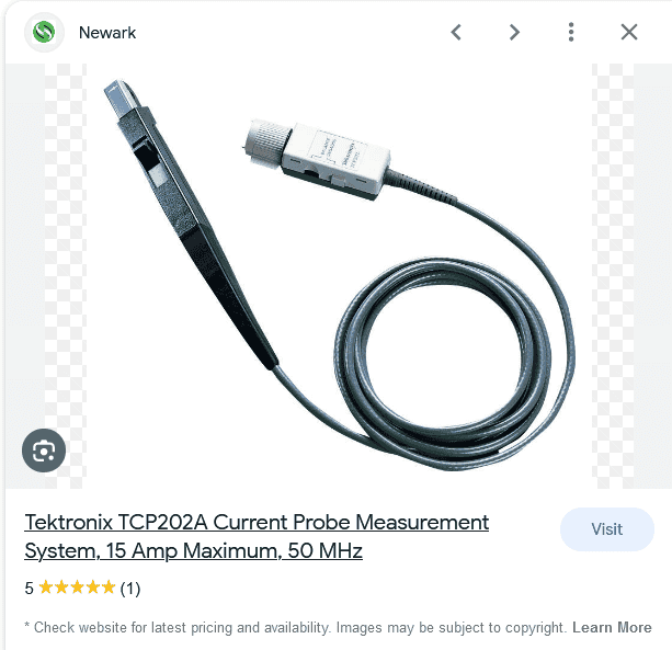

To make the current measurement that you've defined so far (as best as I can tell), you can just use a production Hall Effect current clamp like one from Tek or other vendors. What is wrong with that?
https://www.newark.com/tektronix/tcp202a/probe-current-1-oscilloscope/dp/24W8886
